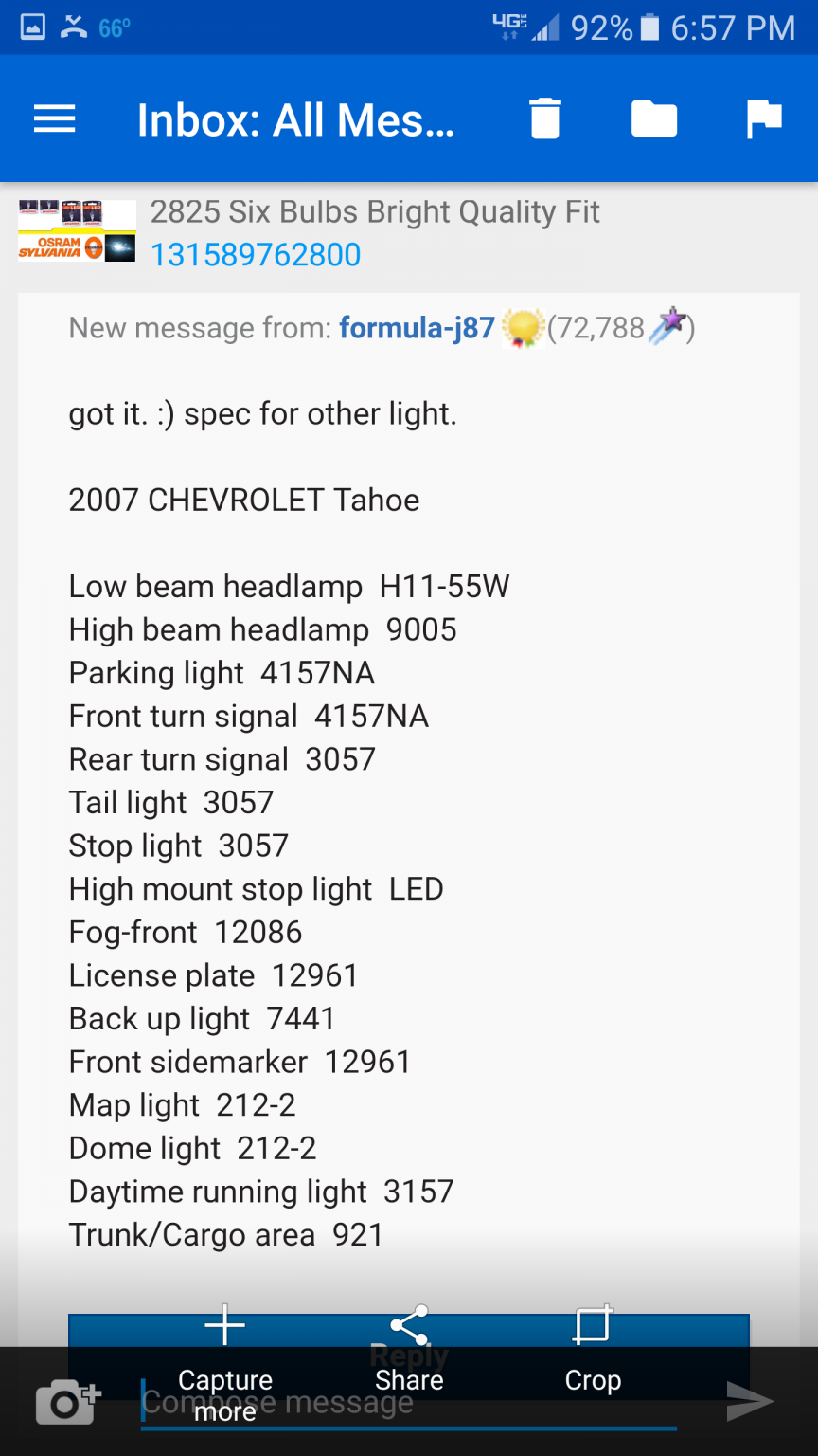

Look this guy up on ebay he'll haggle you a little bit and he sent me this list when I bought the Sylvania leds from him

Just a couple more questions:
1) What colors do I need these in? Obviously the stop light is red. And the turn signal I'm not sure if it should be yellow or amber to make the yellow lens brighter? Same with the side markers and running lights.
rear turn signal 3057
stop light 3057
front sidemarker 12961
daytime running light 3157
2) Do you have this ones model number?
high mount stop light LED
