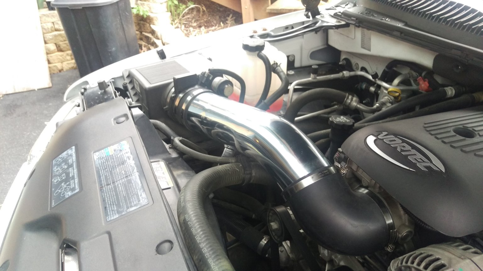

BlackBear Tuning did a test. Get an AirAid Jr and call it a day...
this is the answer.
CAIs give you a power "boost" due to colder air, problem with our trucks is that we ALREADY have a CAI in the stock box. You can gain a modest increase with a better tube (less restrictions) and a hi-flow filter. I bought a cheap CAI kit, and connected it to my stock box, because I didn't want to (or have) $150 dollars for an intake tube.

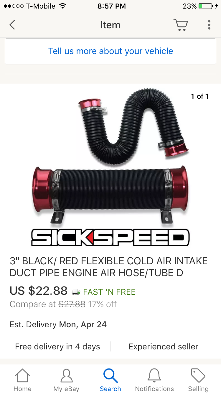

What about these things?

I looked at them, 2 things.
1) your TB is a 4" hole, so get a 4" pipe.
2) those accordion type pipes still create a lot of turbulence inside, while it might be ok for a short distance, I wouldn't really want one in there, especially when you can do it with one straight pipe.
2) those accordion type pipes still create a lot of turbulence inside, while it might be ok for a short distance, I wouldn't really want one in there, especially when you can do it with one straight pipe. View attachment 79699
Did you buy a whole intake kit and use just the pipe?
