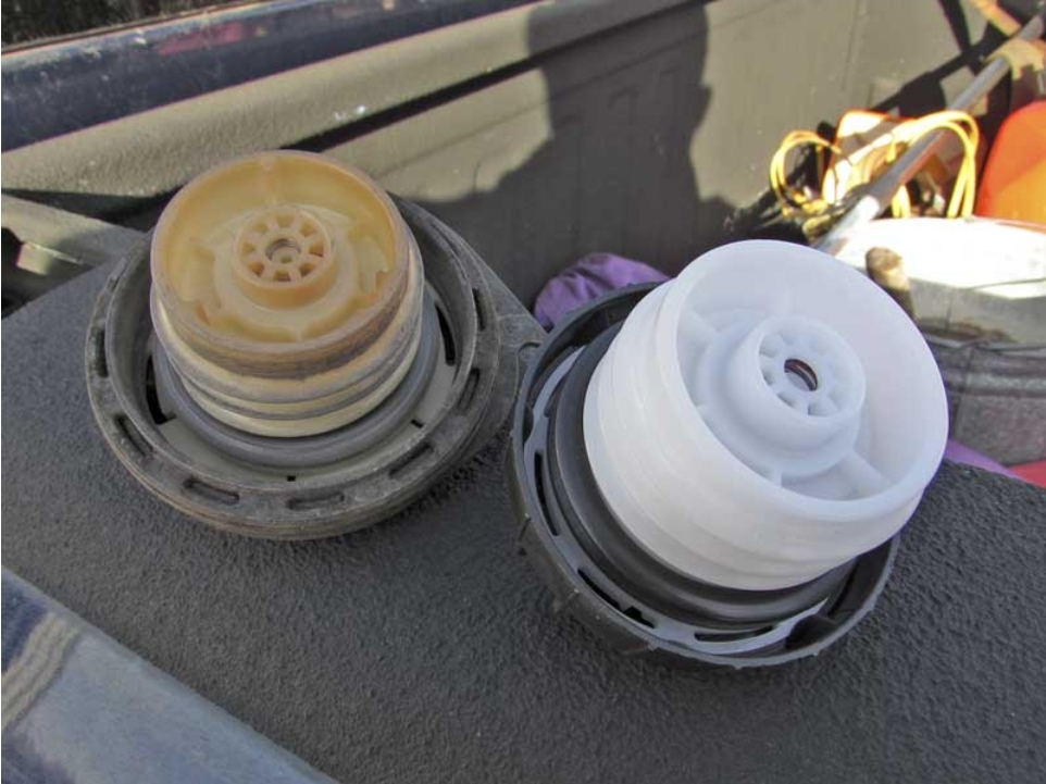

Any idea where this could be coming from. Gas cap is on tight.
markni12301
Nov 4, 2018
83
60
Good that you first checked the gas cap. Inspect it closely, check the seal too. And is it covered with fuel resin.
And is it more like the one on the left or the right.

Gas cap was pretty crappie. I replaced it with a new cap and the service engine light came back on. It’s not affecting the performance of the truck while driving however I hate having the light on. Do you suggest I do or look any where in particular?? Ty
