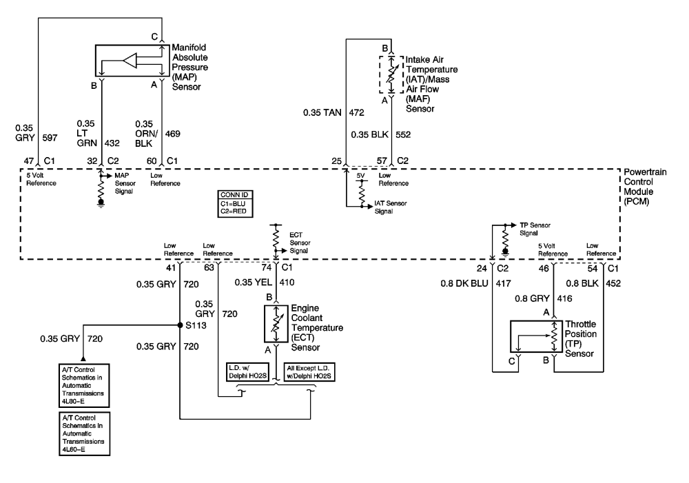

rockola1971
Dec 29, 2016
2,862
4,085
Indiana (formerly IL)
Check the Gray wire (with engine running) for 5 Vdc. Check Orange/Black wire for ground (the MASS gets its ground from the PCM). To do this stick positive lead of meter on battery positive then ground lead of meter on Orange/Black wire of MAS Wire plug. You should see 12 Vdc or higher on your meter. (Do all this with engine running). If your ground is missing then your PCM has a problem. If ground and 5vdc check good then you have a broken sensor wire (Light Green) between the MAS Sensor plug and terminal C2 32 of the PCM or a junk MAS sensor or C2 plug at PCM is corroded and needs to be disconnected and cleaned of all its green monsters.
