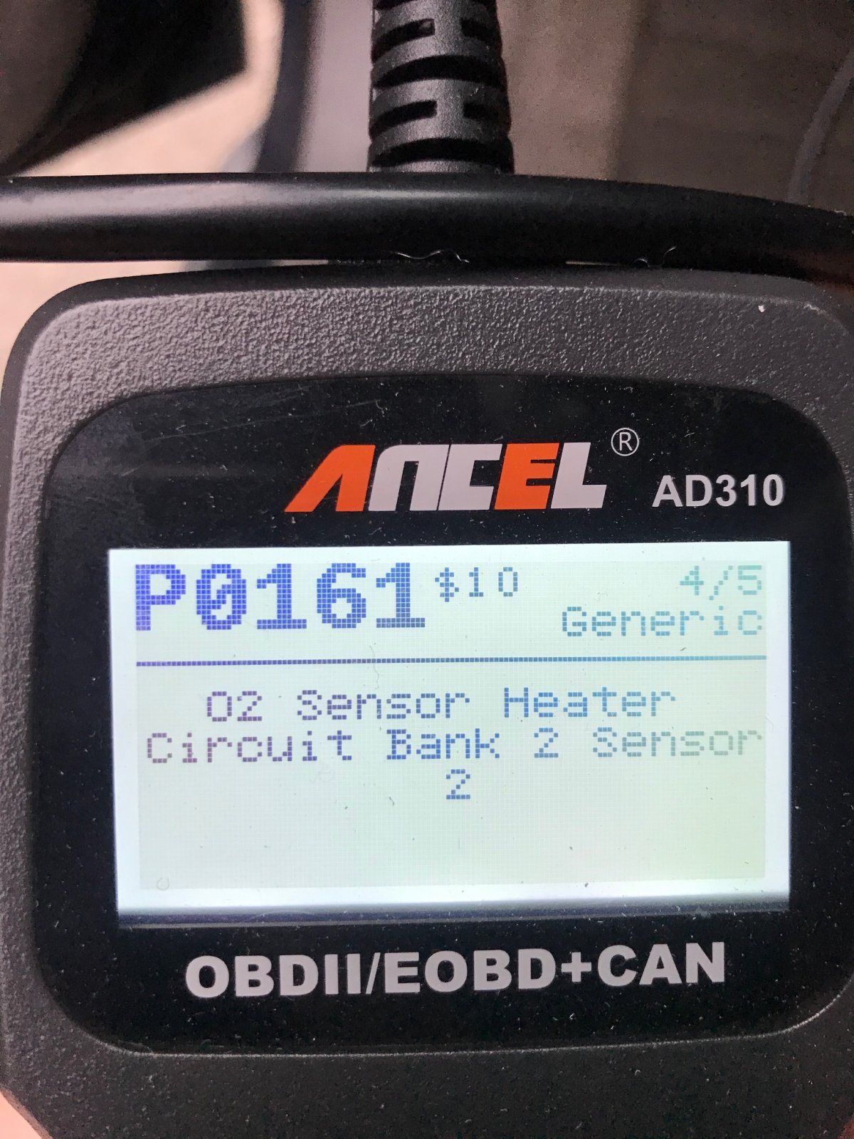

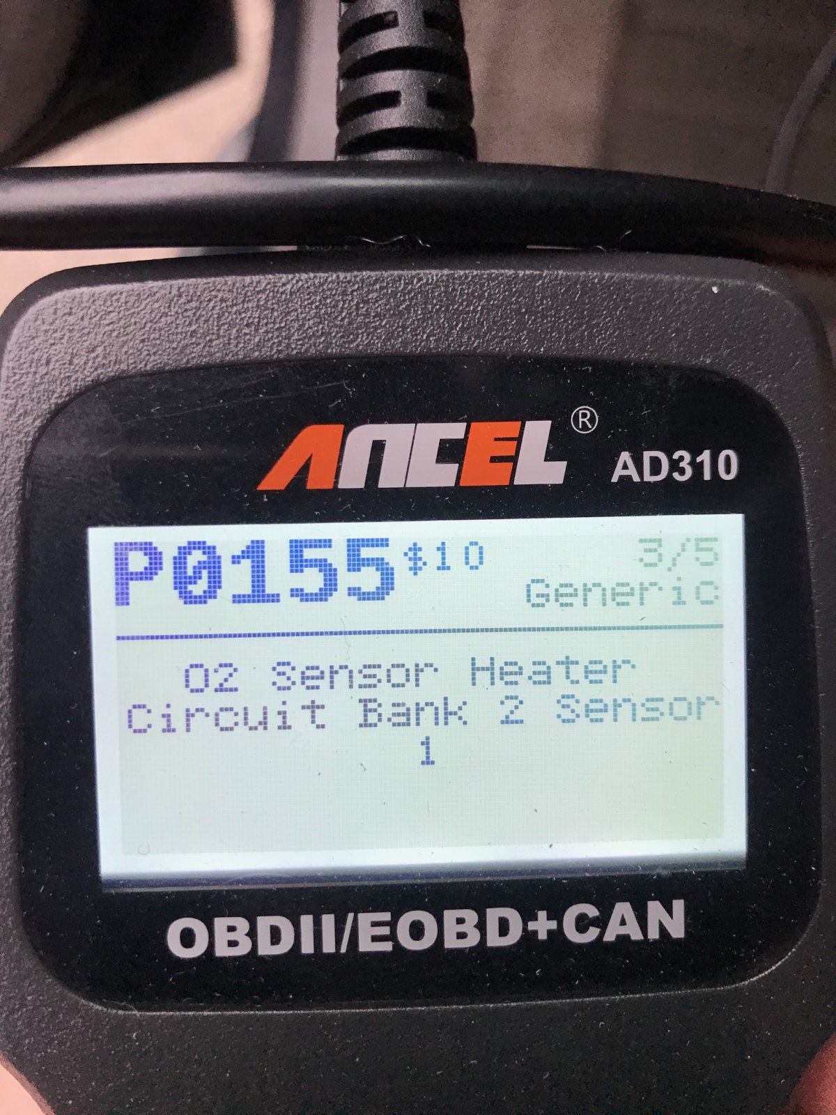

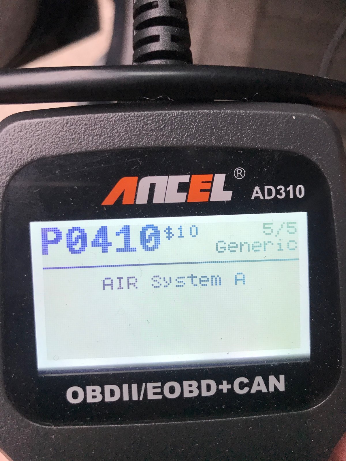

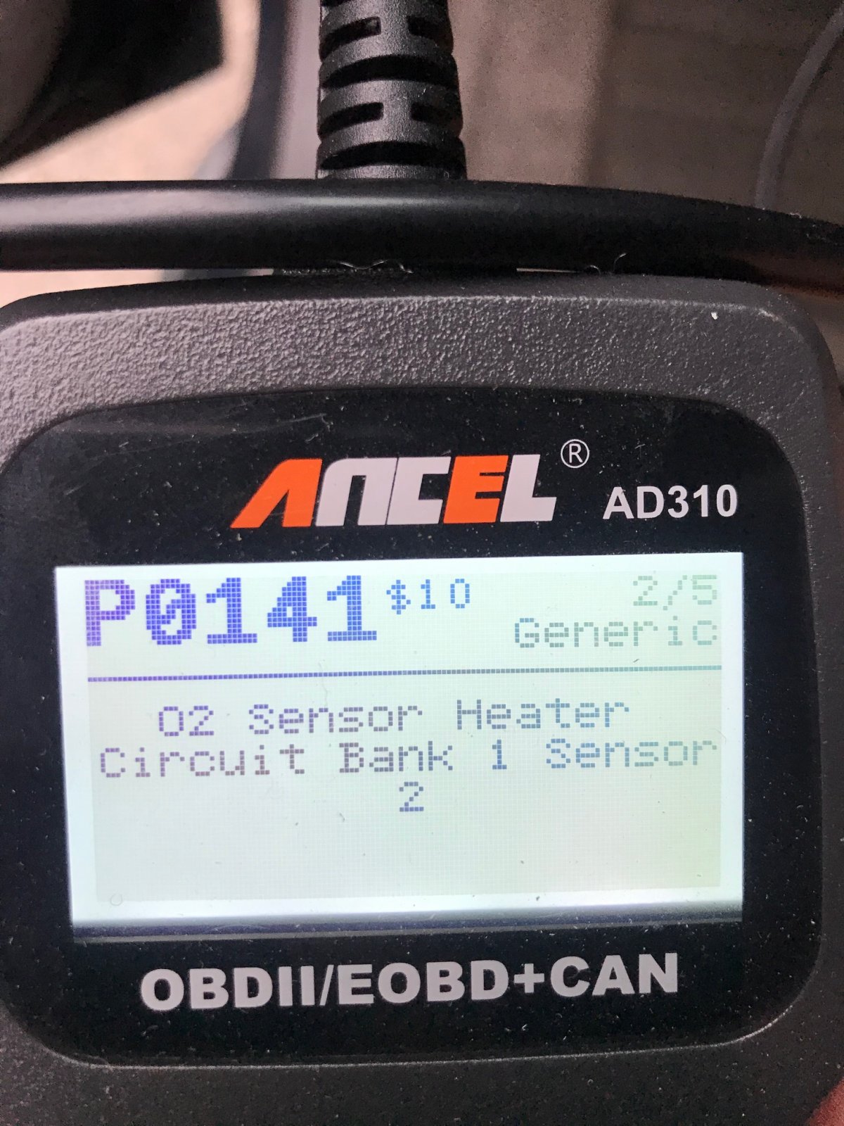

Wow I wasn't expecting all the quick responses! thanks everyone for trying to help out so far. i currently have 5 codes, i figured the last code (P0410) was worth asking in this thread as well. I'm still learning how to use this forum so i apologize if a lot of information is missing. If i need to give any more information, do let me know. As for getting numbers while idling and etc that Fless has asked for, i will try and get them tomorrow as early as possible
As for the O2 sensor codes:
P0135
P0141
P0155
P0161

View attachment 256247 View attachment 256248 View attachment 256249 View attachment 256250 View attachment 256251
That's what I thought, you might have a wiring problem. A critter may have chewed through some wires further up along the wiring harness. If all that looks good, it's time for a new engine computer. If you wiggle the wiring and the values change, then it's wiring. If not, computer time.

The o2 codes that you have are all for the heater circuit, not the actual sensor circuit (that would be different codes). A bad o2 heater can cause the codes that you have but the chances of all 4 going bad at once is nearly impossible. Do not replace anything until you verify that the heater circuit is good, Start with the fuse. All that the o2 heater does is allow the o2 sensor to warm up faster, giving the computer a more accurate reading during the first few minutes of operation. The heat of the exhaust keeps the sensors hot within a few minutes of starting and the heater is no longer needed. The other code that you have has to do with the air injection system which also only runs during a cold start and is monitored by the o2 sensors. Disregard the air injection code until the o2 problem is solved. Since you have the 5.7L engine in a 2000, that would indicate that you have an old body style Tahoe. There was a mid year change in 2000 to the new body and 5.3 engine. To avoid confusion when doing an internet search, plug in 1999 Tahoe instead of 2000.
