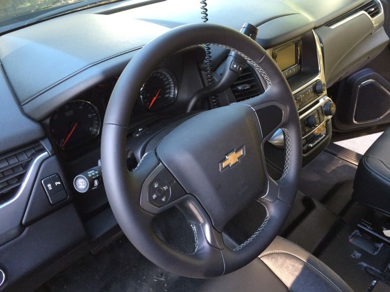

It's 2 years later but at least the thread has a proper home and I am wondering if some folks may be missing out on some of the nicest features of the 2015+ PPV - it is a high performance sports truck with a 100,000 mile warranty :). So I am re-posting my original thread from the GM forums.
Our 'Update the PPV' project is underway.
As delivered:

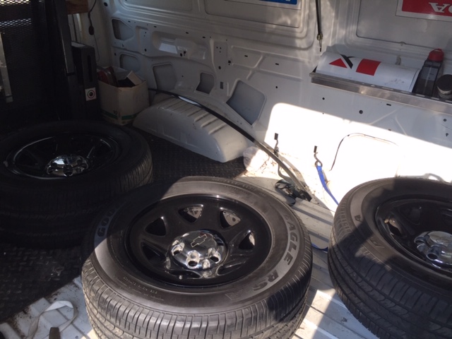

1st order of business was the simple stiff like 17" alloy wheels, tow hitch cover and LTZ leather steering wheel upgrade:
The phone/DIC control pad was removed for now. I may put it back in the future.
