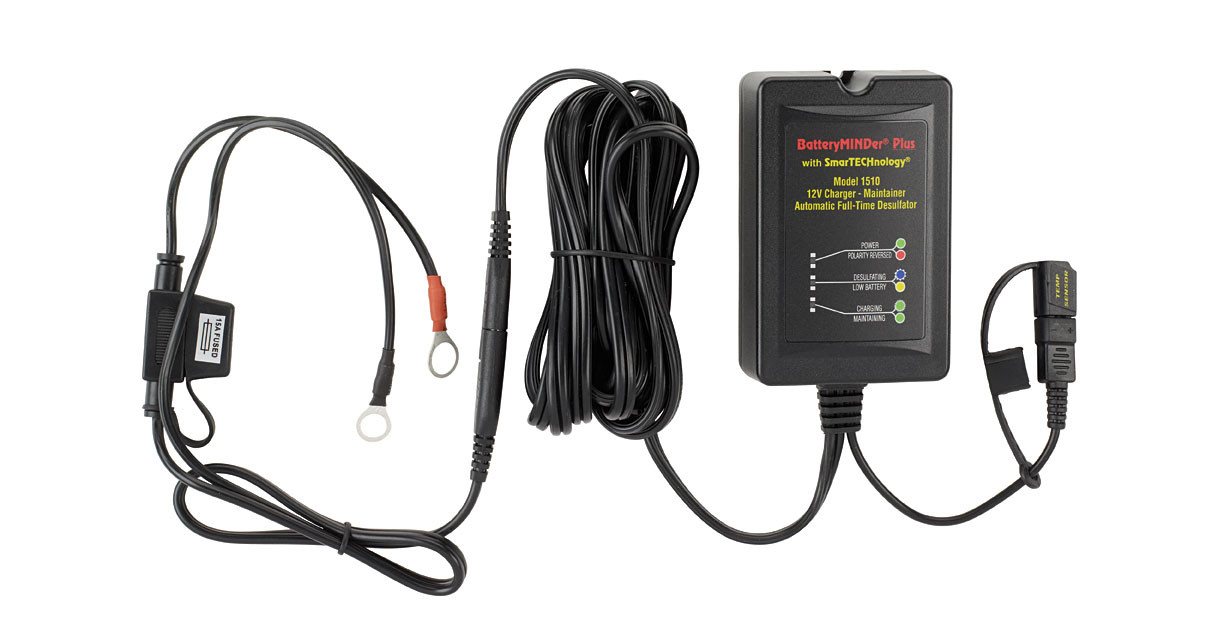

Get a battery tender and put quick disconnect ring terminals on it for when it sits. This is what we do.
