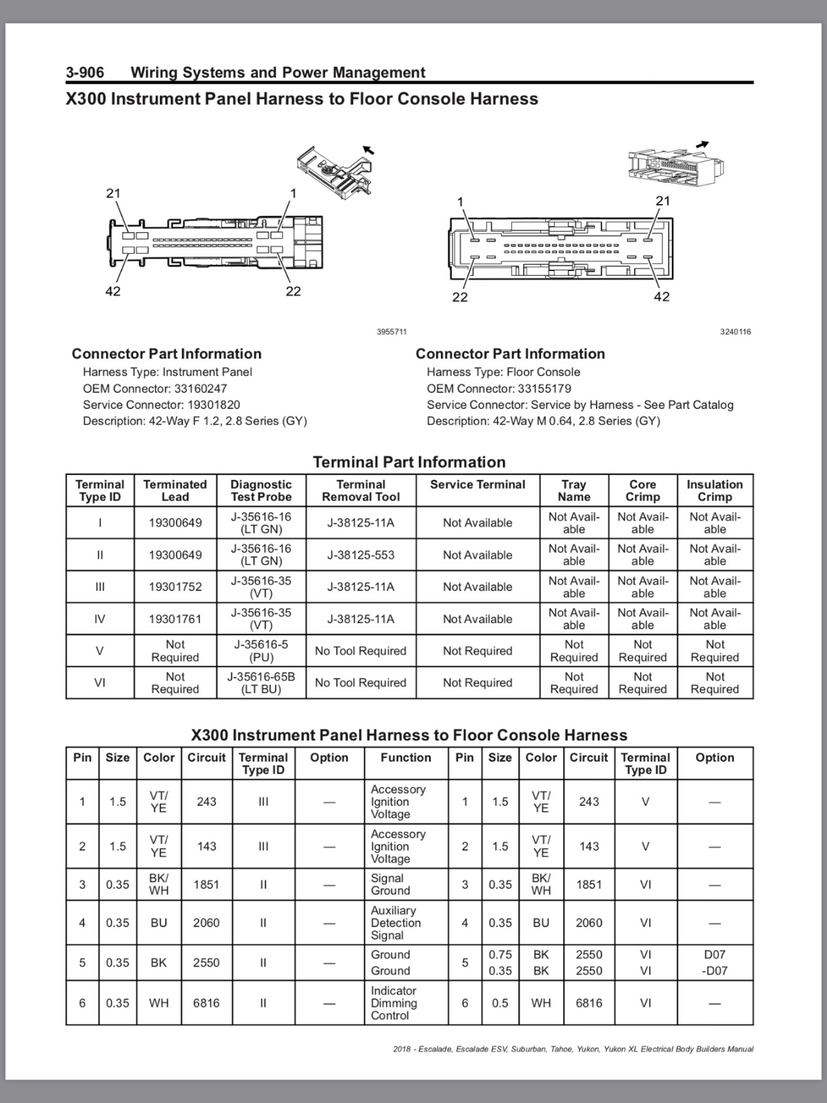

I found on eBay a centre console with the cooler, but when I went to install I am trying to work in the wiring harness, does anyone have a schematic of the pins and what they are for on the escalade centre consoles and also know what the voltage for the cooler is.

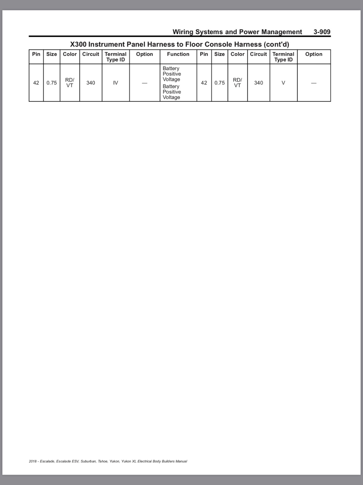

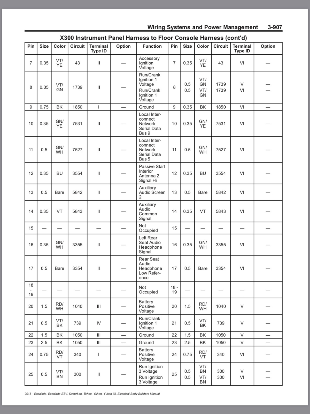

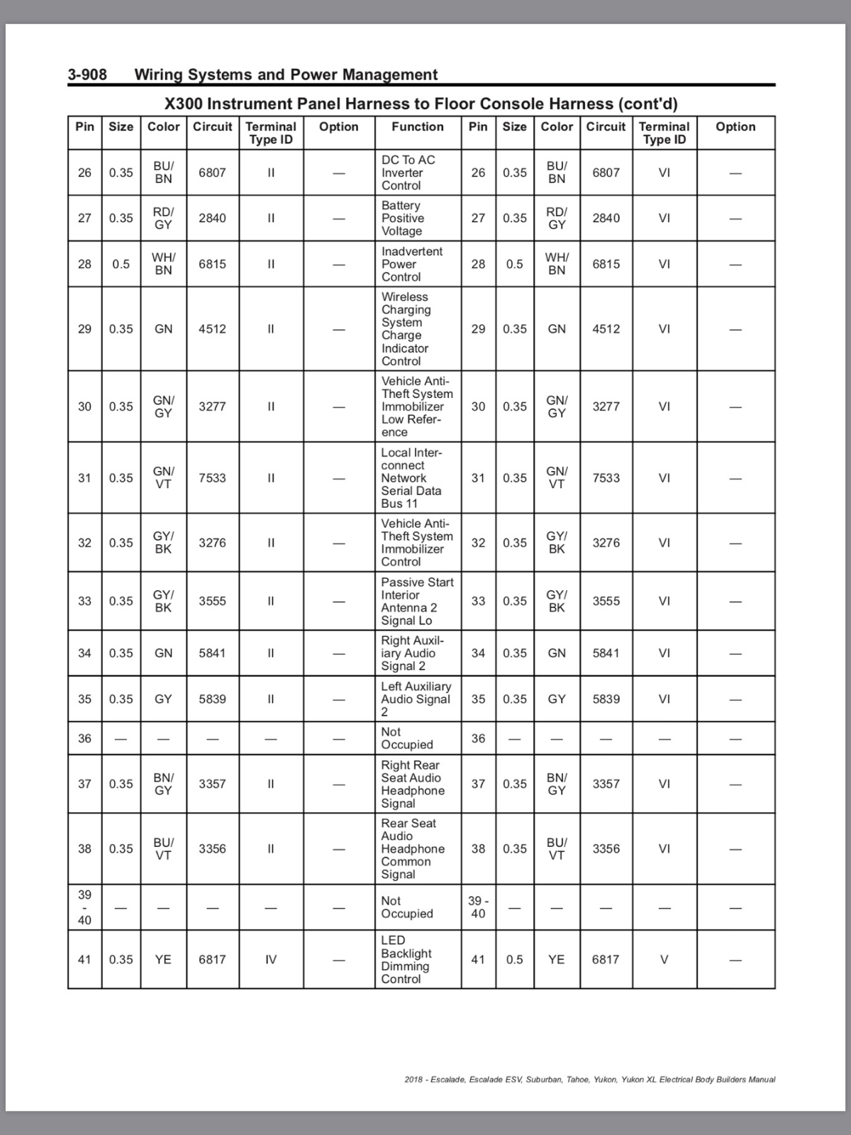

Here’s the pin out for the 42 pin X300 large center console connector. The RPO code for the cooler is DCK. You’ll want to identify the circuits related to the cooler and see if they are present on the side of the connector coming from your dash.
