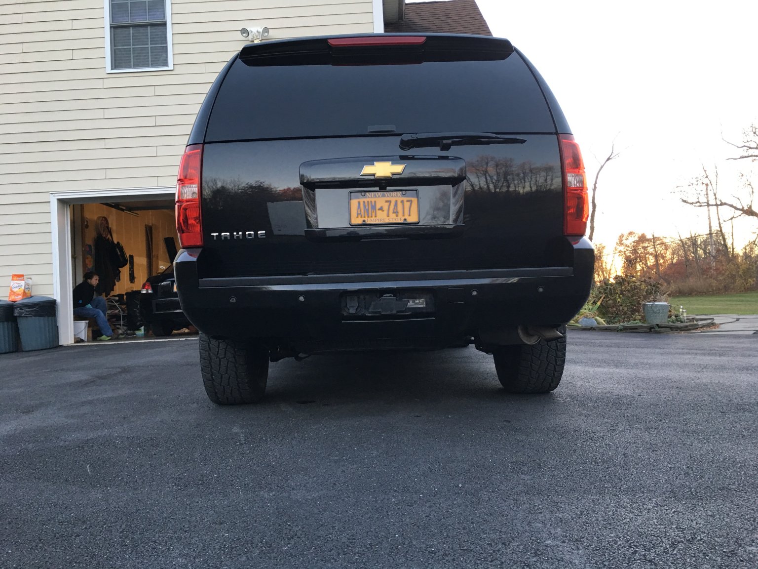

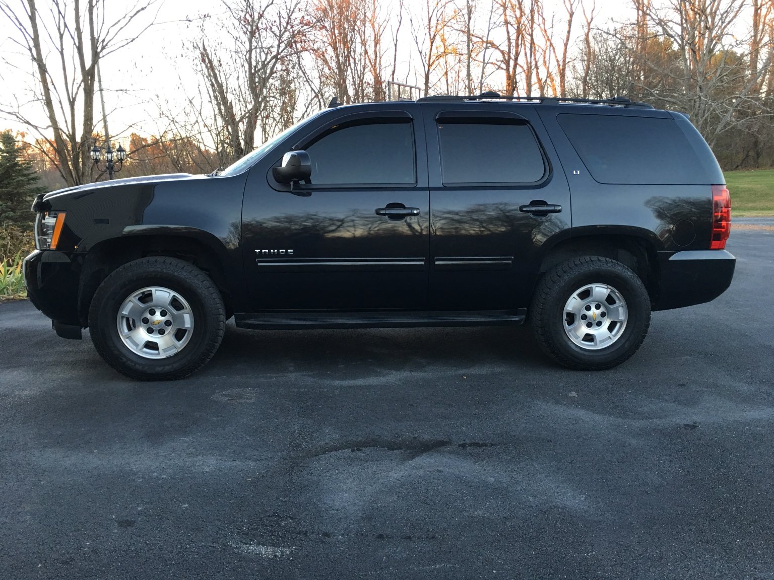

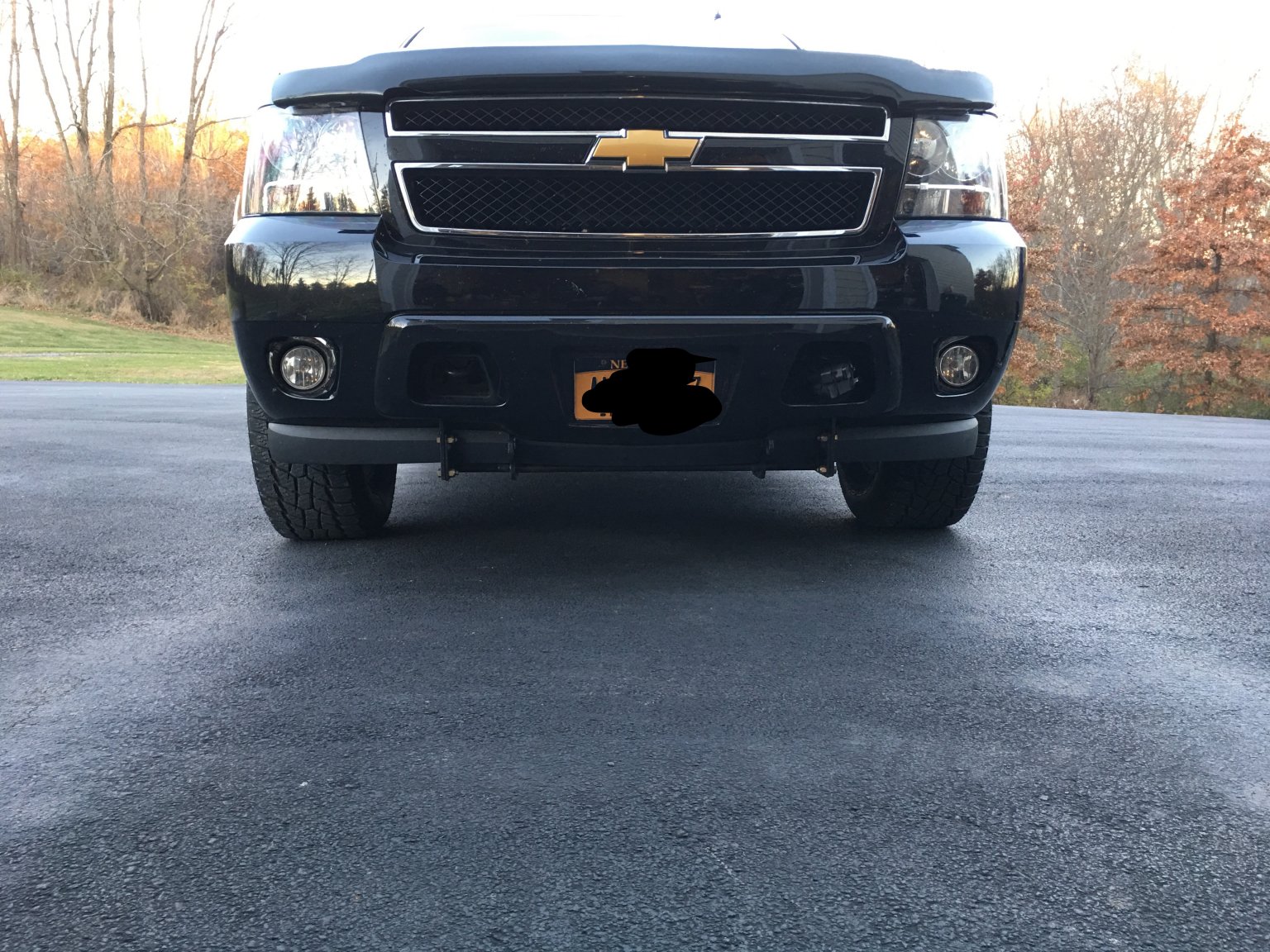

'13 hoe stock 17's 2857017 2" rc level
PG01
Nov 6, 2016
15,686
21,100
Up here to the right
Believe it or not, and i love them, Hercules Terra-Trac ATII p285/70/17 they look beefier than any of the stock b.s. and they were great in the snow (i also have a plow on this truck) they are quiet and feel pretty damn good to be honest. I have about 15-20k (maybe more maybe less dont remem) on them and they still look new...ive been running them between 36-39 psi ( makes them feel stiffer to me) and there is no excessive wear and with the 2" rough country level i have no rub at all. Well, i took off the mud guards i put on because they were grabbing the corner of the flap in reverse at full lock. I could have trimmed the guard but i like it without, makes them look wider and even beefier. I might hear shit that they aren't a good tire but I don't give a f... they were cheap (about $750 mounted and balanced) and do what i need them to do. I just got back from Florida, literally like and hour ago, to NY, and it was pouring last night...drove 24 hrs straight and was doing 75-80-85 through rain with my small 5x8 open trailer and no probs. My 2 cents...

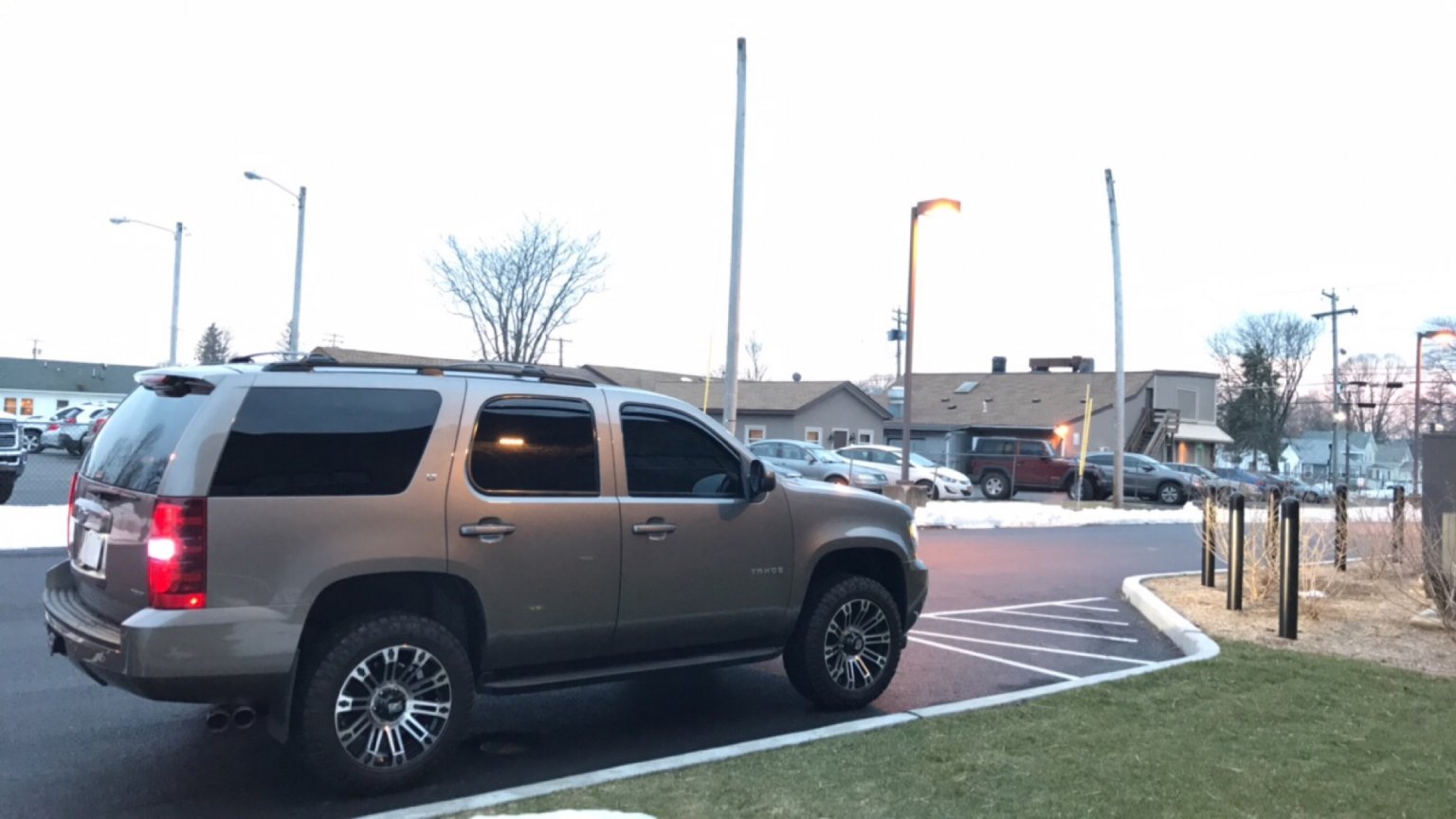

I have a 2011 4X4 with the 2.5 CCM Spacer up front and a 1" in the back... pretty level. I run 305/55/20 Nitto MT's, it took quite a bit of cutting to get them to not rub. Looks great though.
