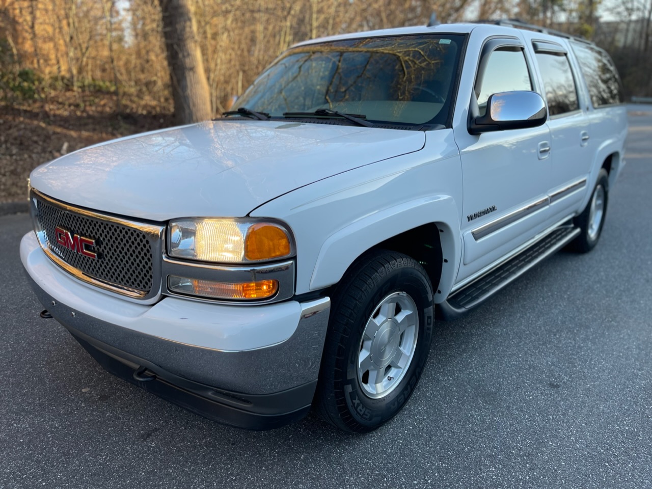

I recently acquired a unicorn. An extremely clean (so clean you could eat off of it) 2006 GMC Yukon XL with 108,000 original miles on it. One owner vehicle that an older man bought new. I noticed after driving for a few days and parking in the garage it smelled like rotten eggs. It doesn’t really run bad. Seems to have a decent amount of power. It has a slightly rough idle though. I sprayed brake cleaner around the intake (no change). I then removed the throttle body, cleaned it with throttle body cleaner until it looks new again, cleaned the MAF with mass air flow cleaner and left the battery unhooked the entire time. Did the idle release process and it didn’t seem to help.
A buddy of mine that’s a GM tech put his GM scan tool on it and confirmed the rear o2 was reading funky so it’s not getting good airflow through the cats. What’s my best course of action here? Everyone I’ve talked to is just saying cut the cats off and delete it or gut them out and delete it. I have a buddy who tunes LS powered cars for a living and said he could do it no problem. But, then I read horror stories about how they run like crap and fuel mileage takes a huge hit as well. Not only that, this is such a nice vehicle I don’t want to just cut the cats off off it. I checked the price of a new Y pipe through GM with both cats and the price was over $900
