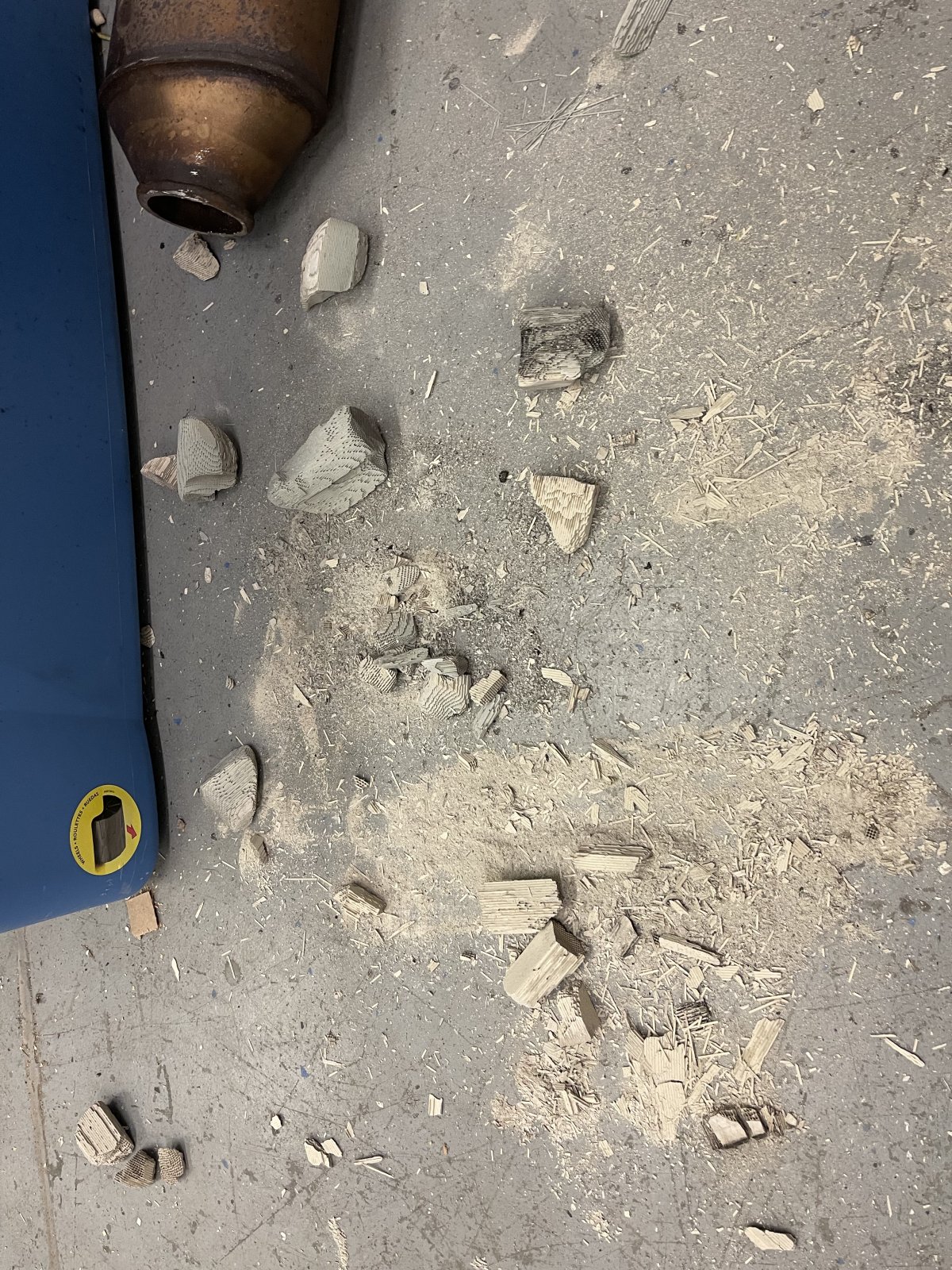

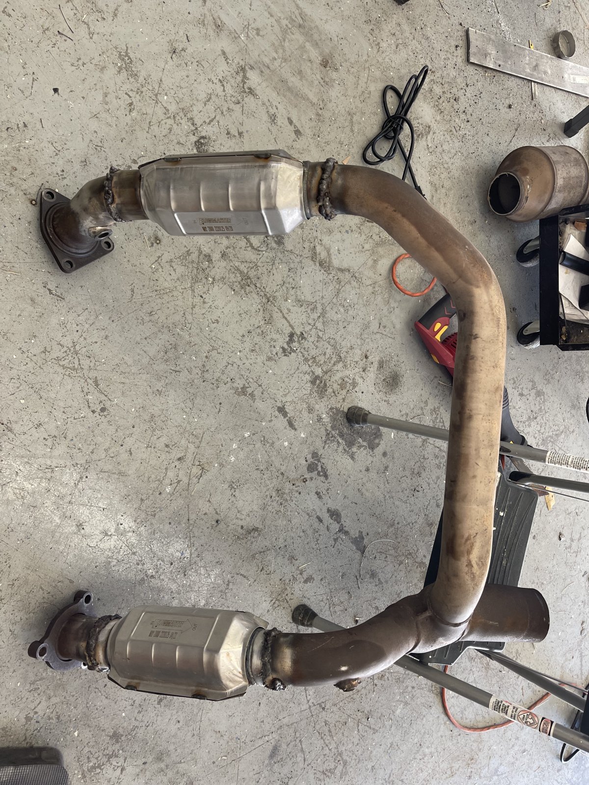

I use flowmaster cats. Had to replace one in the 03 Yukon Denali and have since cammed & tuned it and it’s the cat is still working great after 40k miles. i had a broken 3rd cat on my wife’s 11 Sierra Denali, didn’t know it until I removed and already started replacing the RT/LF cats. So removed downstream 3rd cat and replaced the other two, it would start randomly throwing a 430 code so I added an o2 sensor extension and no more code. Ugliest welds I’ve ever made, but everything is running great!
