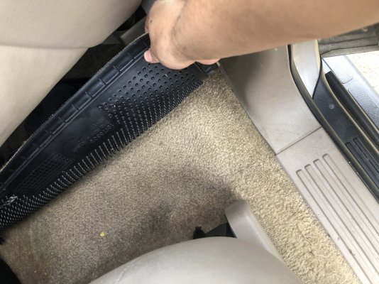

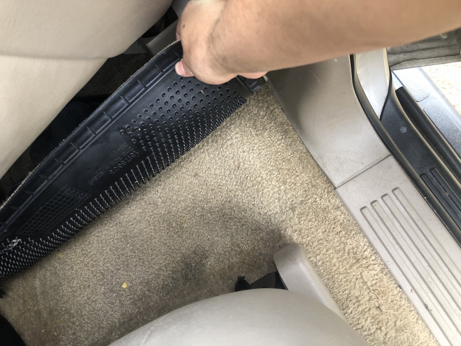

This is where it gets wet/ moist
30,801
48,535
that's unusual, have you looked underneath the body there? any rusted out spots? holes drilled? have you lifted up the carpet there and inspected? I guess it's possible the door seal could be bad or the side glass seal on that side, you will probably have to inspect it a bit to figure it out, there are no inside causes unless it is coming from the front somehow

30,801
48,535
The underneath looks fine but could it be from exhaust?
no the exhaust pipe exits the very rear opposite side, the exhaust as a whole goes down the passenger side
maybe the roof rack is leaking, there are bolts in the roof to hold the rack on that might be something to inspect.
there are not to many logical reasons to have a wet spot right there. door seal, roof rack, side window seal.
the only thing that could leak inside is the heater cores, 1 is up front by the glove box the other is passenger rear corner, but that would smell like coolant.

So passenger area, between first and second row seats....
X2 with Doubeleive suggestions.
Not likely anything to do with exhaust.
Look for holes or rust-through in the floor panels underneath first .
Still could be a seal that dropped out of place, cracked or damaged seal. Do a visual inspection.
If nothing obvious...
Grab a power washer and have someone sit in the back seat to look and feel for water intrusion.
Maybe do it in stages to try pinpointing to specific section around the door opening...
I would try high-pressure flow over the top of door first, then sides, then bottom edge of door.
It could be where the screws for the roof rack mount come through the roof, but I would expect some tell-tale signs of water damage to the head liner on the way to getting the floor wet.
