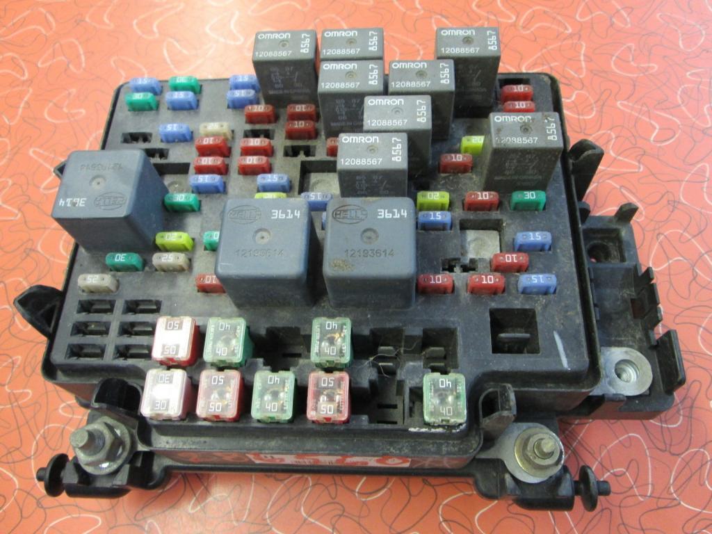

Can anyone help point out which relay is the one for the Air Ride Control Relay
I got my air ride working but the Service air ride is still showing up. The compressor kicks on and kicks off likes its working normally but why would the light be on. I have a scan tool to erase the codes but it doesn't show up as a code. Any help will be helpful. Thank you.

I just deactivated my air ride this AM. I disconnected the 4ride sensors ,pulled the RTD fuse and the #1 big fuse in the underhood fuse panel ,disconnected the battery for a few seconds,reconnect and the light stays off. Possibly try disconnecting the battery it should reset,there are no normal codes to erase.

Im looking for to change my rear shocks from the air ride shocks to the regular shocks and I need to know what relays need to be jumped so the air ride sensor isn't on anymore. If I need to connect a resistor to the power to eliminate the error back to regular sensors with zero errors>> Please help

seriously? You have like 3-5 threads on this already. On the cover you will see which fuse it was, and you need to pull the one that says RTD. We've already discussed this in one of the other threads on this topic
