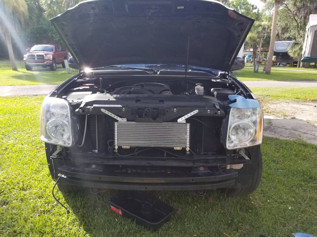

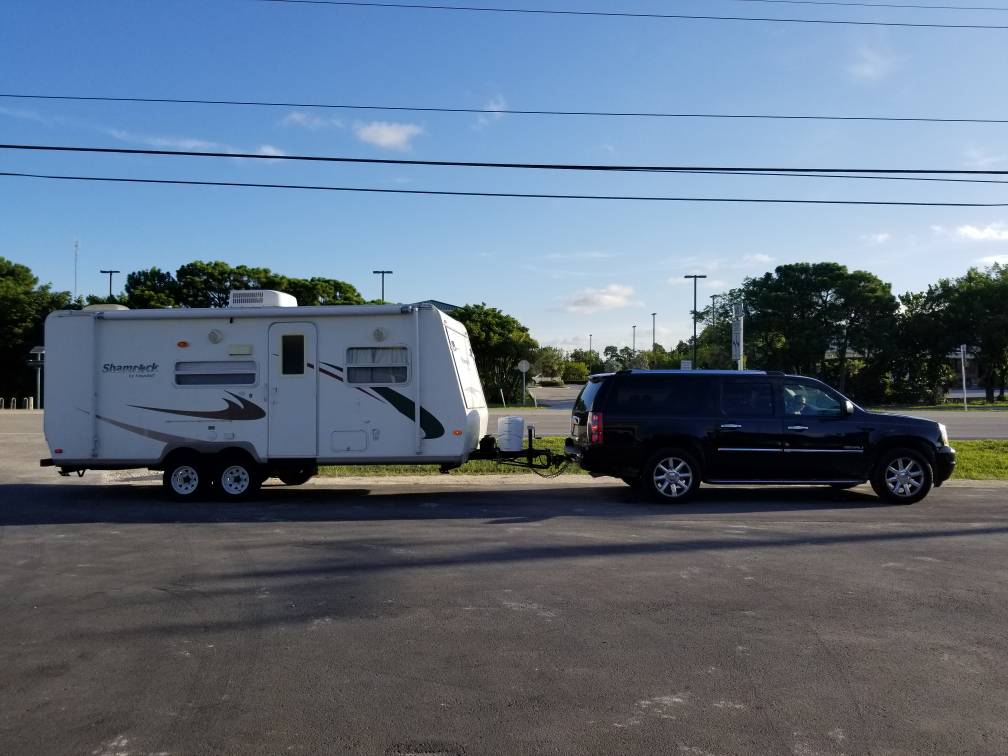

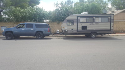

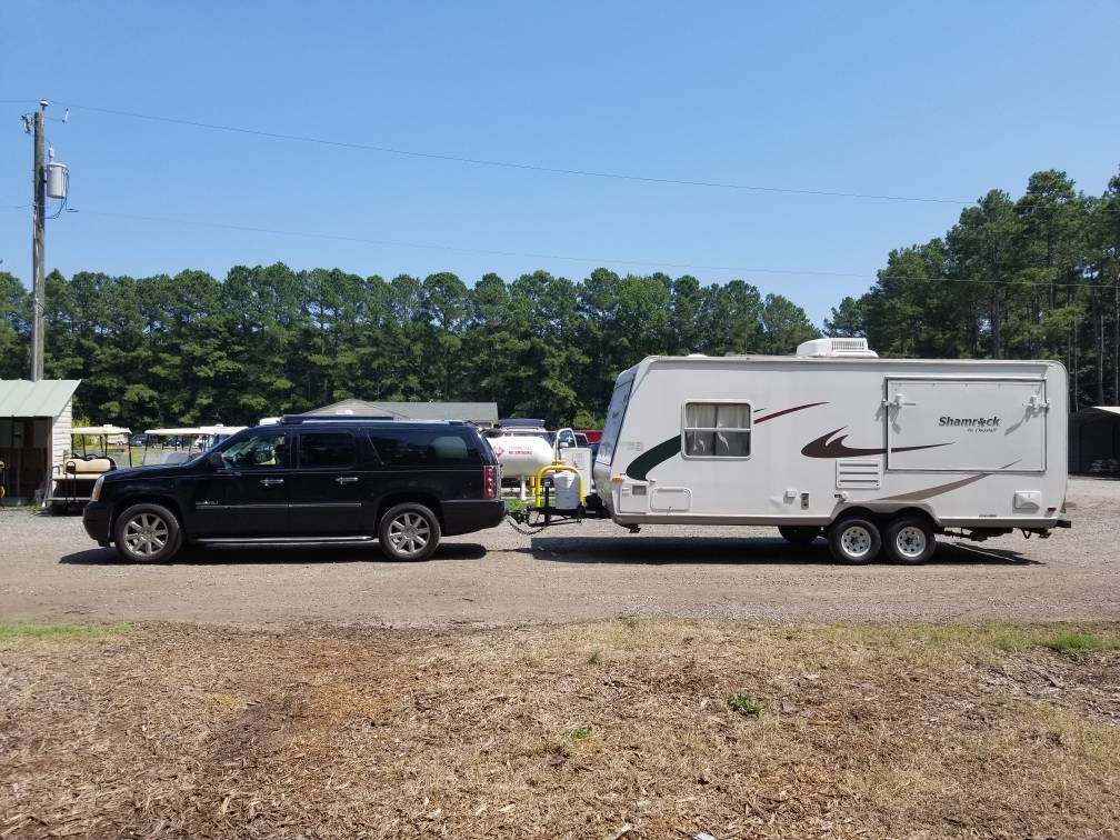

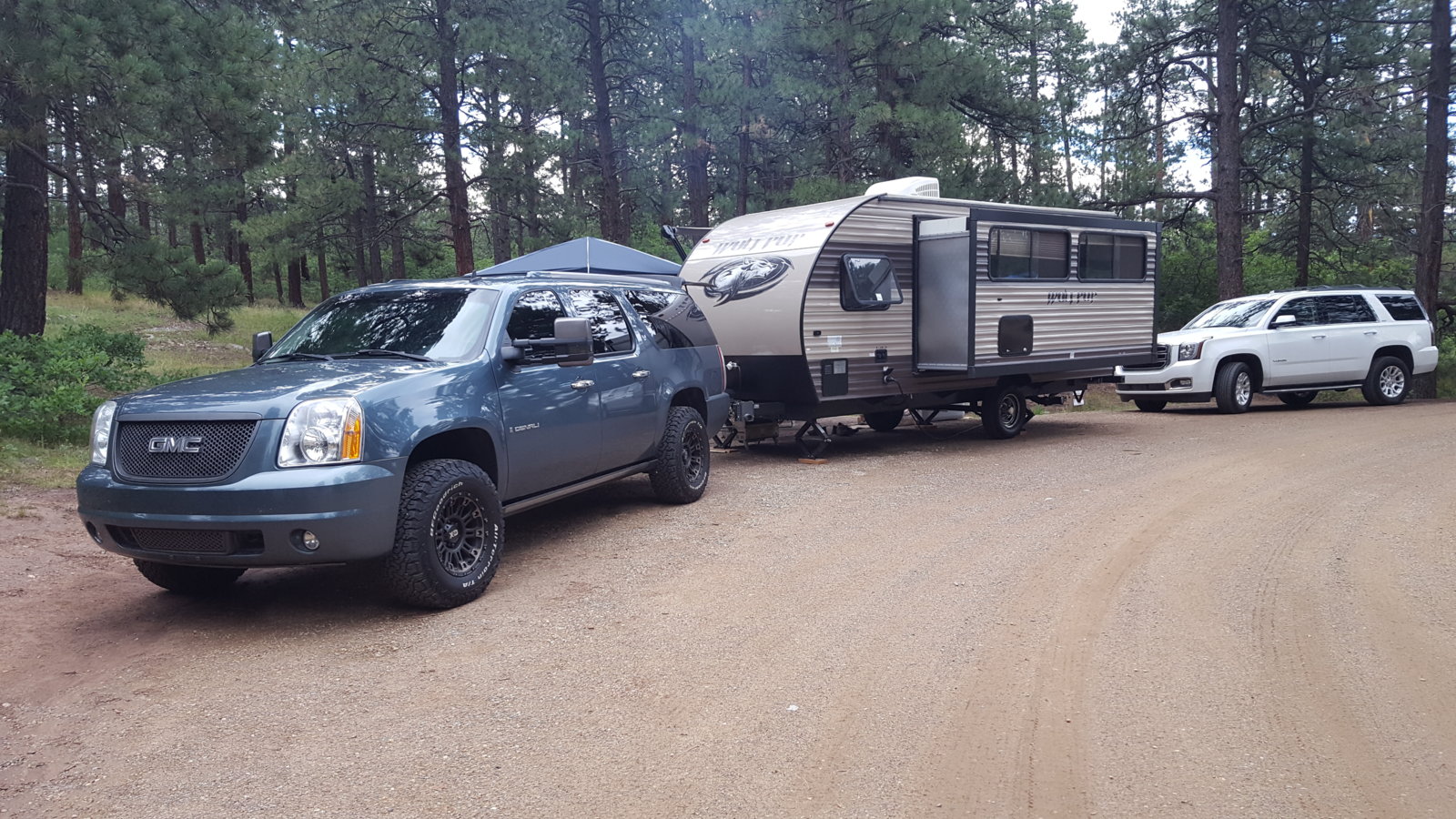

I gathered some numbers from my setup and after towing my TT that weighed around 4500 lbs through the mountains of AZ and CO I wouldn't want to go much heavier. The weak link in my chain was my transmission cooler and going up the 6-8% grades the transmission temp got up to 241 and I had to pullover to let it cool down. I ordered a Hayden 679 cooler to install. I would also recommend a brake controller and really like the Hopkins Insight because the manual control was easy to mount within reach and was nice for going down the mountains.
2008 Yukon XL Denali AWD 6.2L 3.42 gears
Yukon XL Gross Vehicle Weight Rating GVWR 7200 lbs
Yukon XL Gross Combined Weight Rating GCWR 13,000 lbs
Yukon XL Gross Axle Weight Rating GAWR Front 3300 lbs Rear 4200 lbs
Yukon XL curb weight 5608 lbs
Yukon XL towing capacity 7100 lbs
Yukon XL max cargo 1300 lbs
Trailer Gross Vehicle Weight Rating GVWR 5000 lbs
Trailer Gross Axle Weight Rating GAWR 5080 lbs
Trailer unloaded vehicle weight UVW 4012 lbs
Trailer cargo carrying capacity CCC 705 lbs
Weight Distributing Hitch tongue weight 1000 lbs
Weight Distributing Hitch max weight 10,000 lbs
2" ball 7500 lbs
Yukon xl curb weight towing capacity would be 7100 lbs.
If yukon xl loaded to GVWR of 7200 lbs towing capacity would be 5800 lbs.
For me I think the max I would try towing any kind of distance or grade would be 6000 lbs and probably try to stay closer to 5000 lbs.
