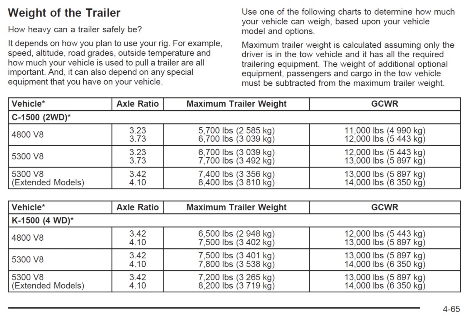

So you are telling me that my Tahoe AND my loaded trailer should not be over 8300-8500 lbs combined? That does not sound right.
Your GCWR is based on the engine and axle ratio, see above pic from owners manual. The "Extended Models" are the Suburban.
