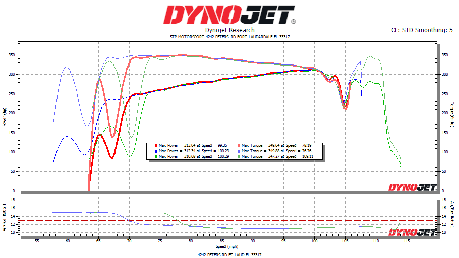

Didn't really have an intended power goal. Just as much as I can get out of it. Lol. I think my main issue is just wanting everything at once without having the all at once budget. I did some baseline dyno pulls. I attached the graph.

It's a Magnuson Supercharger. The kit is designed to be used with the factory injectors or can be upgraded of course. From what I understand, the factory fuel system is good to about 550 whp from what I've read.
Have you dynoed your truck with all of the mods?
Do you think an in tank fuel pump will make a difference without changing the injectors or High Pressure Fuel Pump?
I planned on installing the supercharger myself. The cam is a different story. lol I'm not sure I'm ready to take on that challenge. From what I've seen, it's a pretty intense install because of the AFM/DOD delete. So I think I would let the install of the cam and fuel system be handled by a professional. I can install the injectors and high pressure fuel pump, but I've never dropped a fuel tank or installed an in tank fuel pump.

Yes, my truck has been on the dyno several times to include today.
I ran out of injector/maxed out at 360whp @ 5900rpm. I had to go from #38 injectors to #50. For you to be safe, you normally don't want exceed your duty cycle past 80-85%.
The blower is a pretty straight forward installation wise..........but the cam and AFM/DOD delete is definitely more in depth and requires more tools/knowledge.
Injectors are an easy install, but there comes a point where you need more fuel pump too. Once you get into the fuel system......unless your a tuner, you will need to have your truck towed to the shop for tuning or you'll flood the cylinders with fuel.
