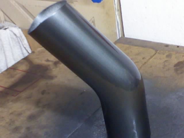

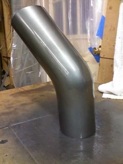

I made my own as well I used the AEM BruteForce design and bought 4'' thin wall pvc tube and started to form it the to exact shape as the AEM and this is what I ended up with after a few trial and errors but I very proud of it!

The problem with the homemade systems (as some members here have found out) is that the fitment is not exact, thus exposing many leaks.
For anyone running a CAI, we encourage that you check your fittings every couple hundred miles.
DarkTahoe00
May 3, 2009
632
IN
That is true! I've had no problems with mine thou! But thats not to say everyone will every case is different! And Thanks Rivieraracing!
