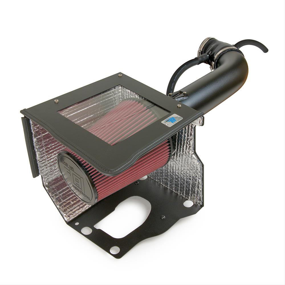

I put this one on mine, it atleast has some shielding, without a box around it then doing that is pointless anyway.

I don't have a box around it yet, mine just didn't come with the top lid/shield, just the foam seal that I doubt it making anything close to airtight when I close my hood. I'm thinking instead of putting a vent on my car, altering the outside fender forever, I will put a shield on it and look to get more air from the fender/wheel well and looks like a path to my fog light. I might look into closing those paths in with pvc or something to direct the air to the box and sealing the rest up.

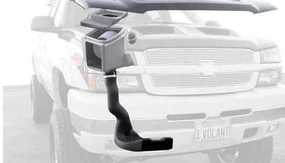

i have this old ram air off a volant intake at home, it mounted in place of the toe hook on my escalade. Wonder if it work on the suburban ? ill try to have a look tonight
