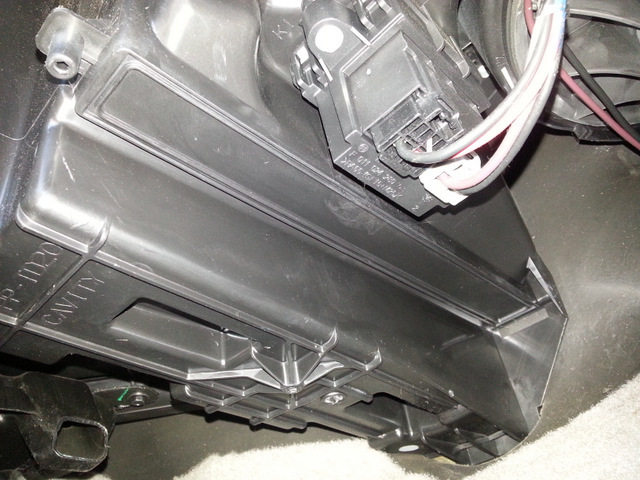

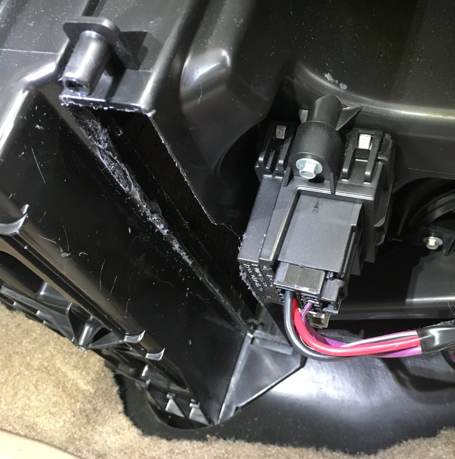

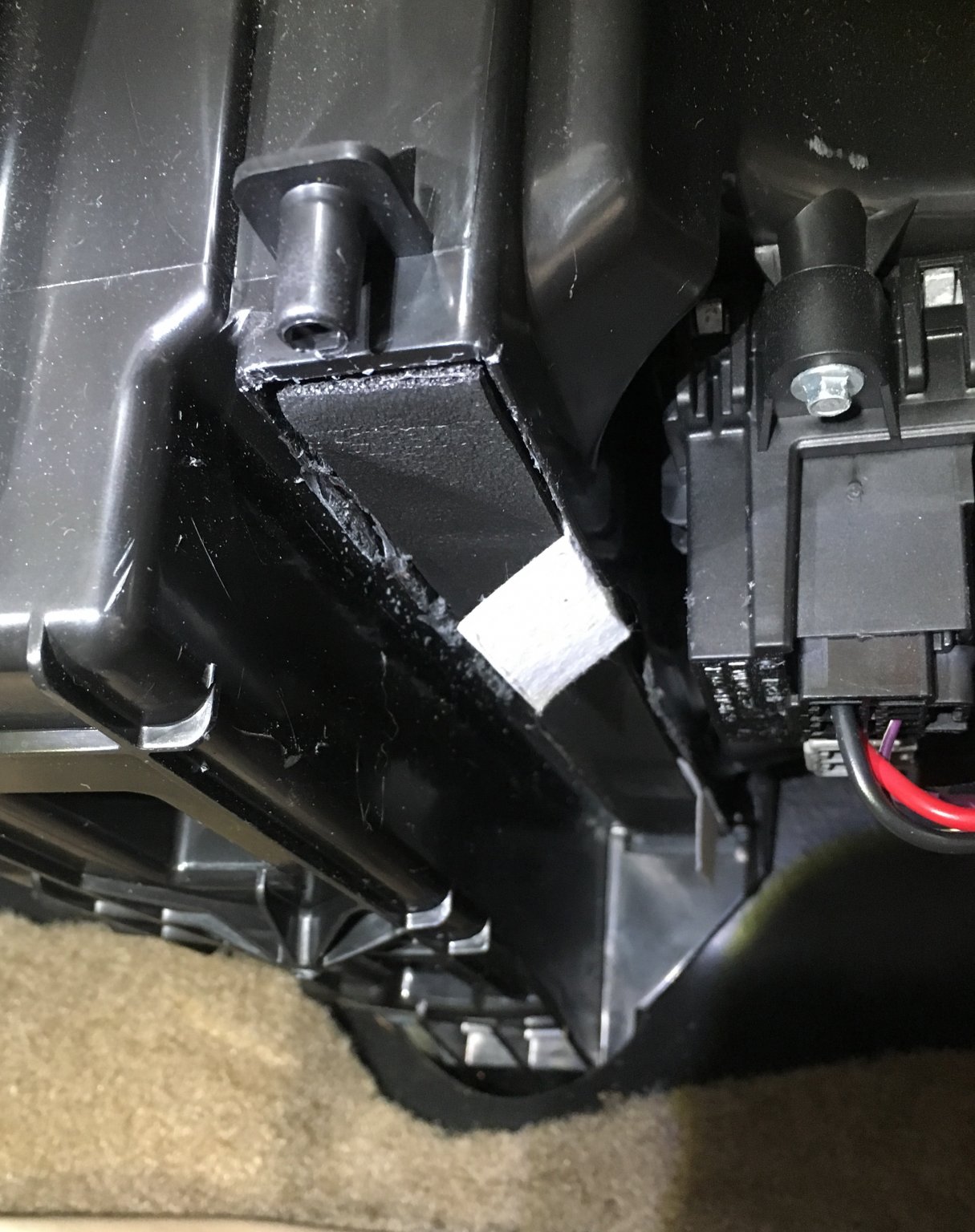

So, I bought a cabin air filter on an auto parts website (while I was shopping for more important parts) for my 2011 Yukon, only to discover that these vehicles apparently don't come with cabin air filters after 2007. Interestingly, the filter came with instructions, and it turns out that you CAN put a filter in a 2011 Yukon. The filter housing is still there, between the heater core and the blower, but it it sealed off with no access door. You take a very sharp utility knife and cut along the rectangular groove in lower part of the housing. Basically, you MAKE an access door, slide the filter in, and then tape, glue, or caulk the rectangular cutout back in place.
I did it and it was a real pain to cut. Don't try to cut all the way through the groove at once. Make several (many) passes along the groove with a sharp razor-knife. The groove is not wide enough for a dremel tool or a pocket knife. I tried these, and made a mess of it at first.
Glueing or caulking the panel back on is easy but I made it look messy. The instructions that came with the filter said you could use an actual access door that screws into place, but I didn't look for one online.
The filter doesn't seem to decrease air flow. It is obviously on the cold air side of the heater core.
When I first popped the housing open, it was actually very clean in there (70k miles), so I don't recommend installing a cabin filter. Waste of time, but at least I know how to do it now..
