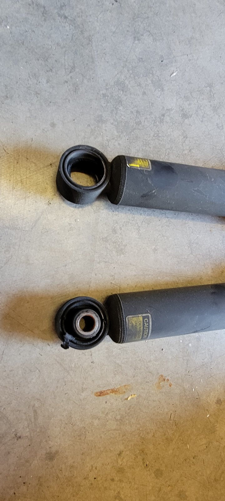

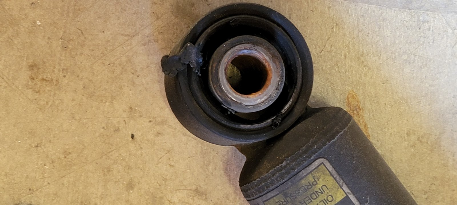

Here is culprit of the clunking, blown lower bushings
