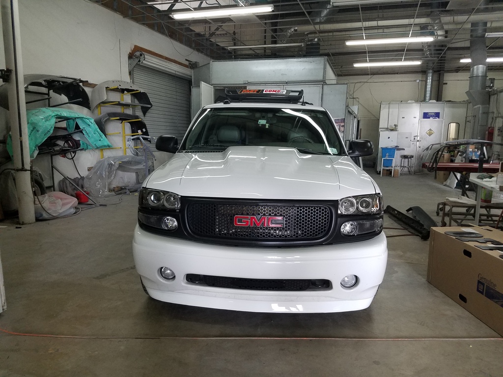

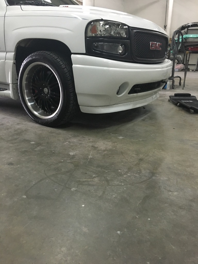

Ok so I finally purchased the front chin spoiler off the tahoe / yukon and had it painted as well as adding the esky rear vents. What do you guys think.
@Ridculous what chin spoiler is that? I bought one but it doesn't reach the corners of my front bumper and it looks like yours actually does. Kinda hard to see in this pic but it's an inch short at each end.

No I believe it is the same as yours mine is short as well maybe a little less then a inch
Is yours on upside down? The angle on the side seems backwards. I assume it came with holes to mount it to prevent that.
Sent from my SAMSUNG-SM-G900A using Tapatalk
52,949
That would be hard to do; no it's not. I think it was a bad picture. I just took this one of the opposite side. It doesn't fit the Denali perfect due to the compound curve in the front and the fact it's a bit short on the side.

Yup mine looks about the same close up....when I purchased the chin spoiler it was for a tahoe I believe
52,949
Yeah mine too. Only thing we could do is buy 2 and cut and splice to make a longer one.
