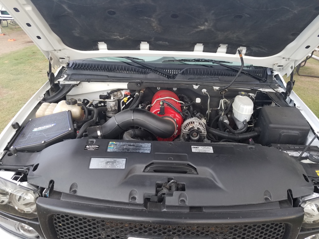

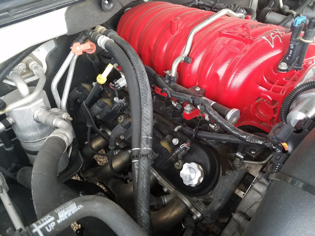

I switched out the stock TB for a c6 Z06 ported TB a couple of weeks ago as well as replacing the tiny little oil cooler for a TRUcool oil cooler that is now located in the lower grill section behind a aussie downunder powdercoated lower valance piece (his last one). Had to buy an adaptor for the TB and get it retuned but it runs a lot better with that bigger TB (the engine is no longer breathing thru a straw!). Next step is upgrading my interior by installing a custom IPAD mini station in the lower half of the center console...Should look trick when it's complete. After that I'm saving up for the transmission swap in q2 - q3 timeframe. Plan on towing my TT in June back to the Rocky mountains and possibly to YellowStone this year.

Much higher than 15k all in but I also replaced all the front shocks, rear air shocks, water pump, oil pump, engine mounts, bushings, steering rack, TRUCOOL transmission & oil cooler, LSXRT intake, upgraded TB, injectors, Volant CAI, SSW catted headers....I could have bought a nice car for what I paid. Also all of the labor putting the engine together was done at a GMC dealer and they gave me a 2014 Denali Arcade for 3 to 4 months to build it as well....alot of money was spent. Figure another 5-6k for the transmission, convertor and labor.

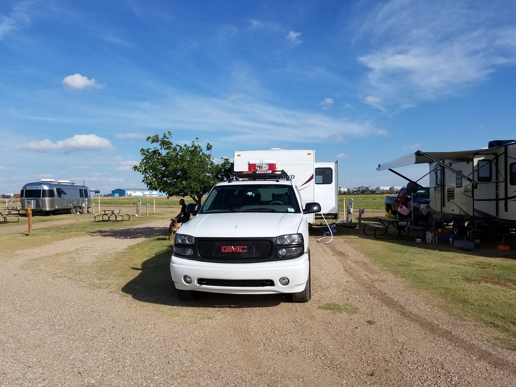

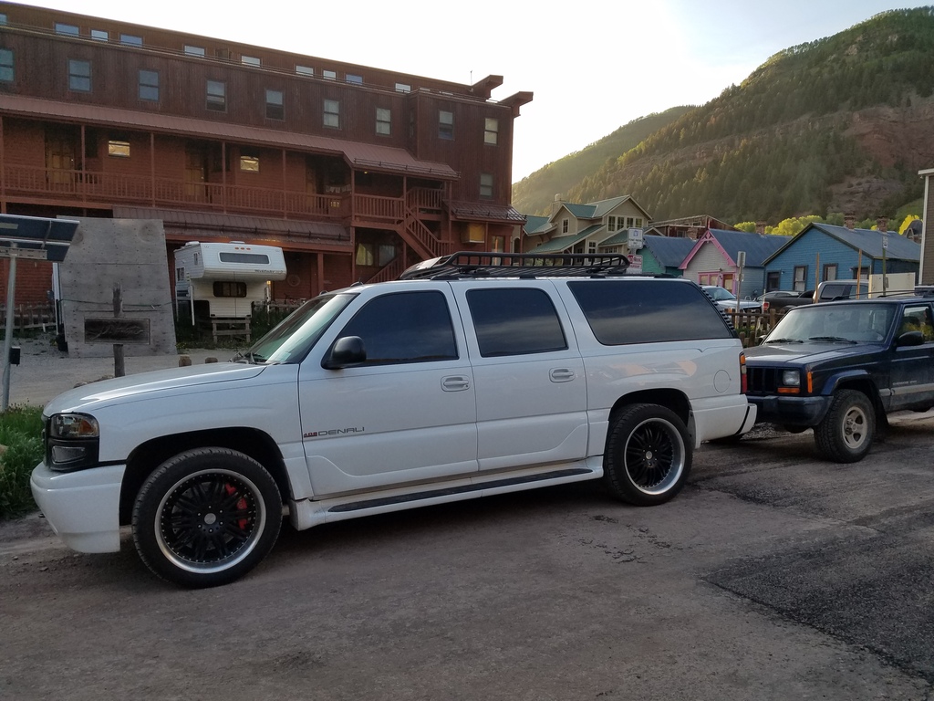

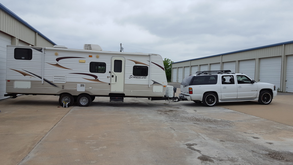

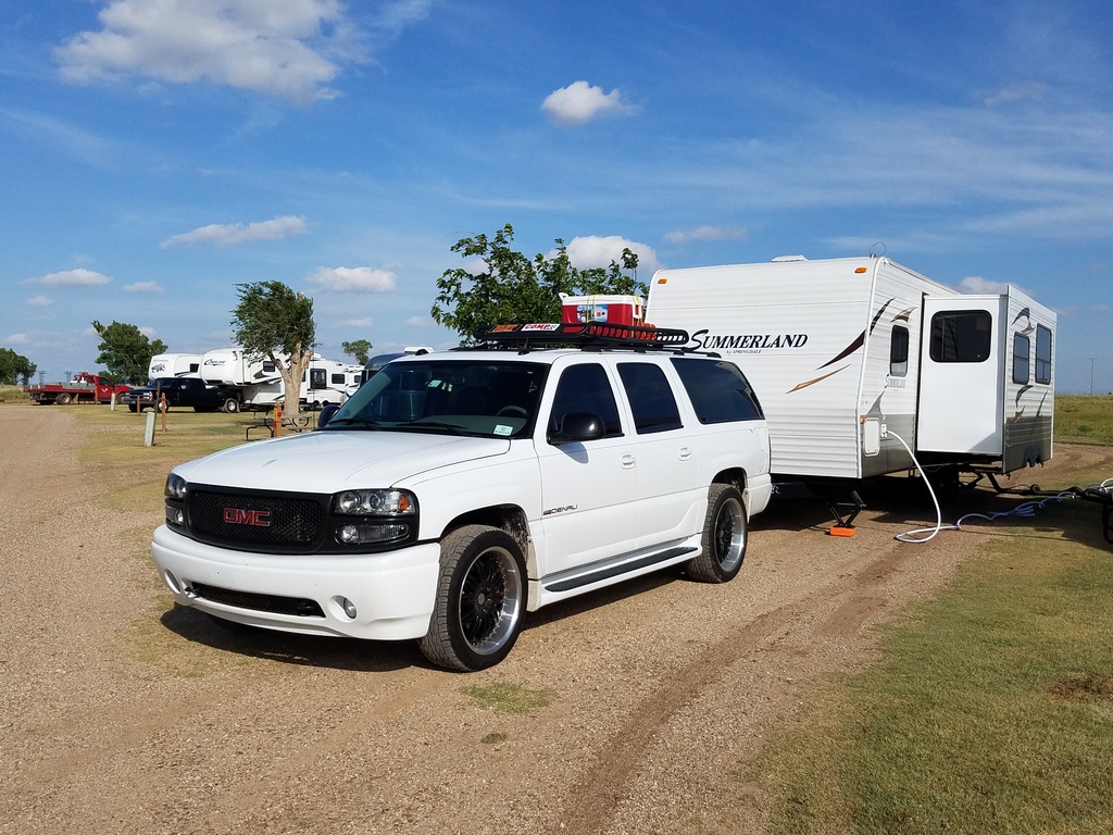

Just completed a 2 week vacation in the San Juan mountains in Colorado towing my 7000lb trailer and 4 adults, 2 kids and 2 large dogs and all of our stuff....the 408 is a brute!

No still stock (has held up for over a year) - it's starting to slip when I down shifted to a lower gear but I am looking at a shop in Dallas to do the 4L80 swap. I will tell you that the beast had no issues pulling up a 7-9% grade for 3+ miles at 55 to 60 mph (an accelerating) on some of the mountain passes. When I had the old 6.0 in the truck with lesser weight it struggled to go passed 30 mph up Eisenhower pass (5% grade I believe)....no issues with power any more and was averaging 7 mph to 5 mph (in the mountains) with a fully loaded trailer and truck. I know I am around 14500 - 1500 GVW with all my crap inside. I'll upload pictures later.
