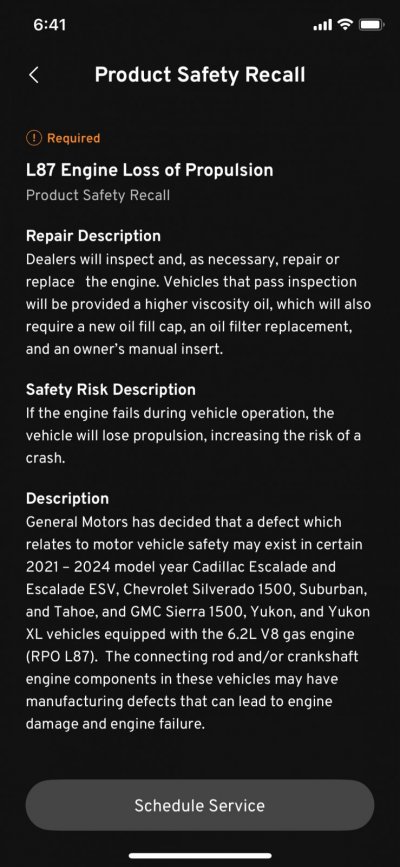

BREAKING: GM is officially recalling the L87
GMCChevy
Oct 13, 2024
434
472
They've said before thst thicker oil causes issues with the AFM lifters so I wonder if this change might cause shift to more issues with that.
While 20 weight is thin oil a lot of vehicles have been using it for 25 years or more without these major issues so it seems more like a bandaid on GMs part to try to prolong the real issue of defective parts or whatever is really going on.

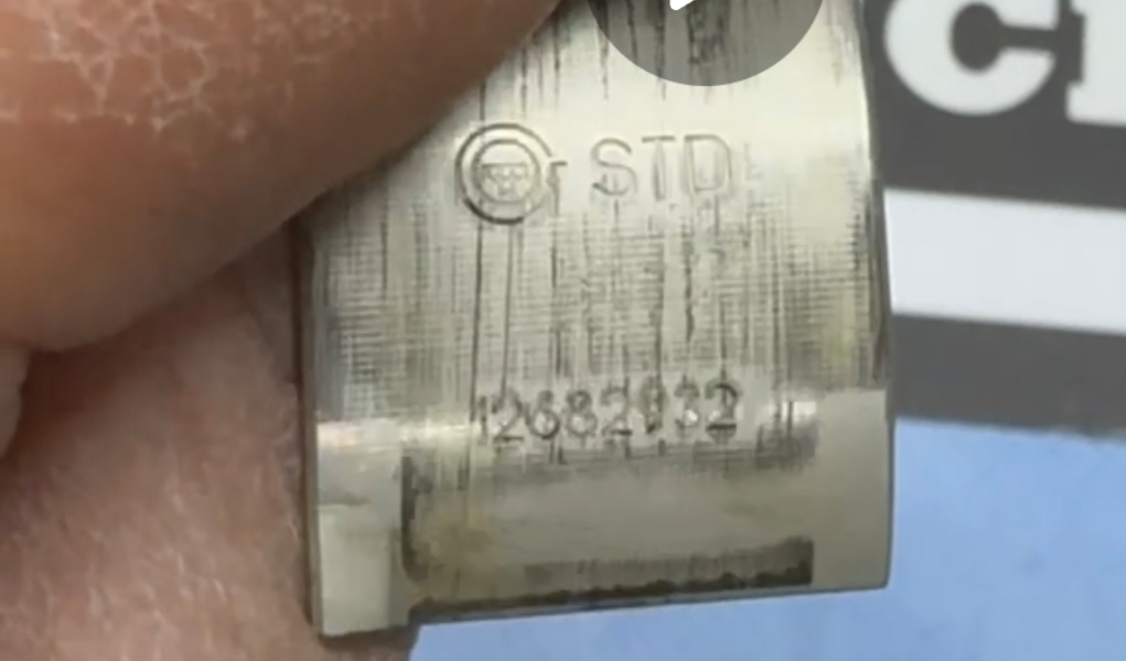

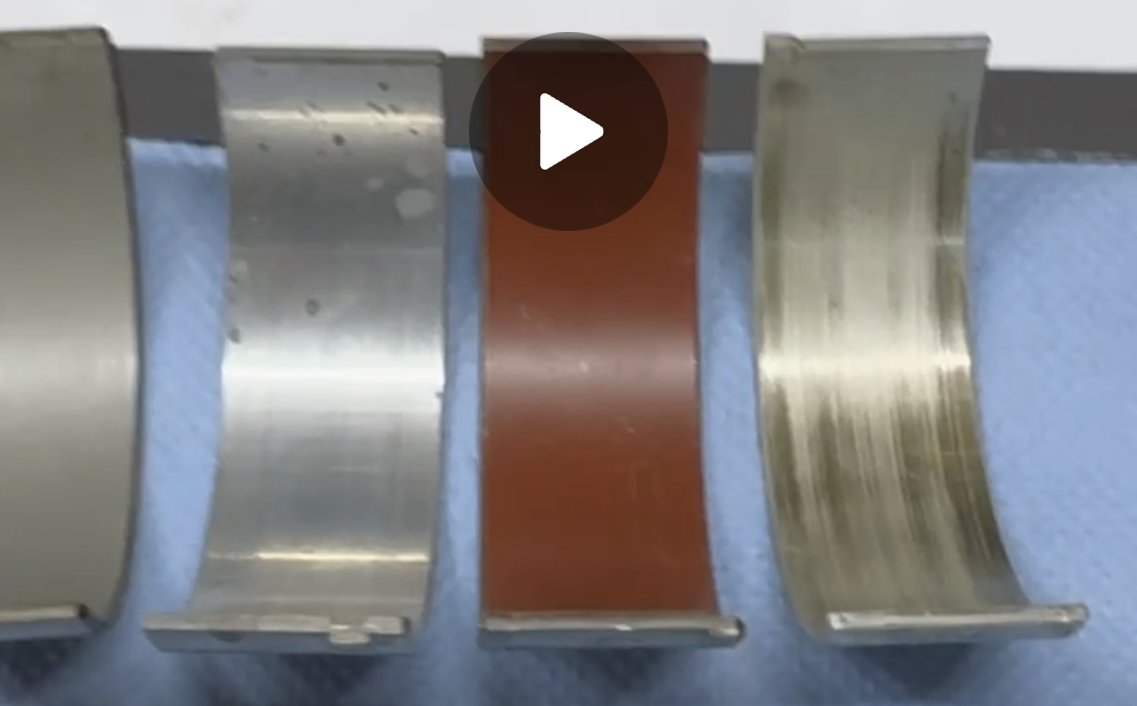

I'll tell you an interesting thing. This is a screenshot of a video from our Russian service, which dismantled four engines, a third-generation 6.2, a fifth-generation 5.3, a fourth-generation 6.2, and a fifth-generation 6.2. They are located from left to right. The left mileage is 150k kilometers, the second is the same, the third is very much, the fourth is L87, about 20 thousand km. The joke is that three left Bearing are made in the USA, and the right one is in Germany. But that's not all. In the l87 engines, the liners are mixed, American and German. The Germans die, the Americans do not break

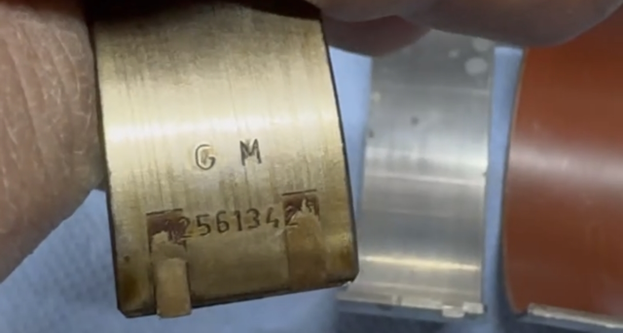

Here is the photo of an American GM connecting rod bearing, and here is the German culprit

I believe that switching to 40 oil is not a solution, it is just an attempt to stretch the cars to the end of the warranty, by increasing the oil film. We still have new engines that are disassembled, sharpened, because they do not maintain temperature gaps
Thats very interesting. I wonder if the German ones are from the same factory that manufactures bearings for the BMW S65. ;)
When I found out that the BMW S65 requires bearing replacement every 60-80K miles I was shocked!! That takes us back to pre 1950s reliability expectations!
Vladimir2306
May 18, 2023
1,064
1,251
I would not link BMW and GM, but everything is possible))

I recently bought a 2019 yukon denali with the 6.2L and 65,000 miles. It's not in the NHTSA recall. What is different about this model than all the recalled ones?
Should I use different oil? I live in hot desert and i tow a travel trailer.
You have a different engine, you don't have to worry

Souvergn41
Apr 6, 2025
I have an early 2021, built in July of 2020 actually. Ran the VIN and I am ok it seems. Are a lot of members here seeing there VIN on the list?
corpnupe85
Feb 5, 2025
Smyrna, GA
I recently traded an 2018 Escalade for a 2021 Tahoe High Country with only 26,014 in Jan. 2025. Looks like I should have kept the Escalade. On 'My Chevrolet' account, my vehicle is affected by the recall. I will be contacting my dealer.
