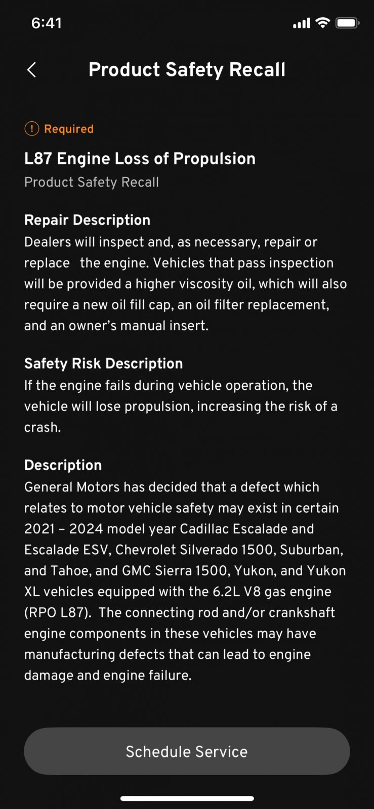

I got a notice of recall on my GMC app. Called my dealer to schedule the recall inspection. They said they are not ready because GM has not told them what the fix is if does not pass inspection. Told me to wait for letter in mail.....
The document is a bit misleading. If they connect a scan tool and see P0016 they are supposed to "Quarantine" any unsold vehicles and mark them not for sale.
Have run my 2024 VIN multiple places and checked my GMC App a number of times, nothing. But I am not worried, I solved this problem at 500 miles and the oil has been changed in my engine 3 times and I did not even have 6000 miles on the truck.
I assume they might either tear down the engines with P0016 for cam or crank bearing inspection, but if a vehicle ends up with P0016, I assume they may just replace the engine??
Funny thing is, I have not seen any P0016 code problems preceding any engine failures.
The majority of the engine failures occurred at highway speed, typically between 60-75 MPH from what I have read.
GM’s notice of recall states (twice) that the recall should only be performed on vehicles in dealer inventory (only).

The recall is for trucks on the road, not just unsold inventory....
GM 6.2l Engine Failure Fix!
Mine failed at 30 mph FYI. Small sample size of course, but highway speeds may not always be the issue. It also states in the attached that they are to inspect the engine to determine if it needs replacing... unclear what that inspection protocol is.
I got a recall notice that states my vehicle has a recall (even though I don't own it anymore). My buddy has the exact same spec Denali I had and he received the recall notice as well for his vehicle (both are 2022's). No where in the notifications does it say it's only for dealer inventory. However, I agree that it does say that if the vehicle is on the lot that they have to quarantine it and are not allowed to release it.
