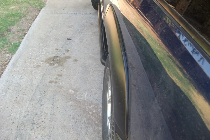

trippers - what fender flares do you have?? (they look sharp)
Any photos showing the profile of the fender flare against the tire?
I can take some pics of the tire/flare no problem,I have no idea what flares ,I think they are stock.I searched for a Dk Blue/black obs for about 3 months,and this one just showed up at a dealer about a block from my job,It had everything you see in the pics already on it.
