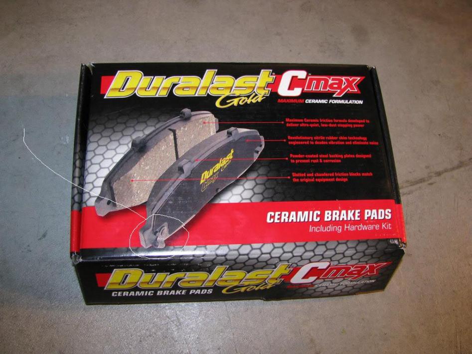

i did add greese to the brake pads. Here is a pic of the pad that i used the the clip im talking about, That clip has at the bottom on both pads for each side. I thought its only supposed to be one pad for each side that has that clip

I dont usually resurface my rotors. If I buy a set from autozone with a warranty, I just replace em with new ones. worse comes to worse pull the wheels and spray some brake cleaner on the rotor face and pads or try to swap em around a bit. Those clips are indicators for when the pads are low, maybe one is pinched. IIRC, the clip should be on the outside pad only.

I sprayed a whole can on each side before and after i installed brake pads and rotors hehehe so iuno im going to have to pull the tires off and recheck it when i get home. Does it matter if i just brake off those clips ?

turns out a clip on the caliper that holds the brake pads was touching the router causing a loud sqweel
