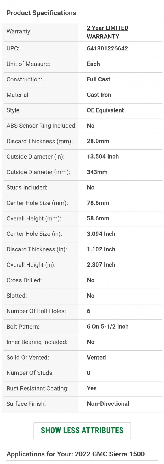

My truck came frome the factory with 20's it's newer then the vehicle this thread was started for but. I have done the brake upgrade on it and have 4 pot camaro ss calipers on the rear. My front rotors that are for a 2019+ are 13.5 and my rear rotors are 13.5.

The inside space on the wheel is 16" at the center, the disk in question is 13"... The 2020 front rotor isnt 13.5 its 13 same as our backs, it might be a smidge over because its some mm number but when I specifically looked it up in inches they round them to 13"

2019+ rotors are infact 13.5.

Sorry on the 13.5 mistake, still, THEY FIT 17S
They actually DONT FIT LOTS OF 20s... WITHOUT A SPACER
BECAUSE THE FACE IS THE ENTIRE ISSUE
LIKE I SAID
STOP LYING TO PEOPLE
YOU NEED EITHER AN OEM WHEEL WITH THE OFFSET FOR FIXED CALIPERS OR AFTERMARKET WHEELS FOR FIXED CALIPERS THIS IS A PROBLEM ON ANY FING PLATFORM WHEN YOU HAVE FIXED VERSUS SLIDER CALIPERS AND YOU WOULD KNOW THAT IF YOU KNEW LITERALLY ANYTHING ABOUT BRAKE UPGRADES ON ANY VEHICLE PERIOD
