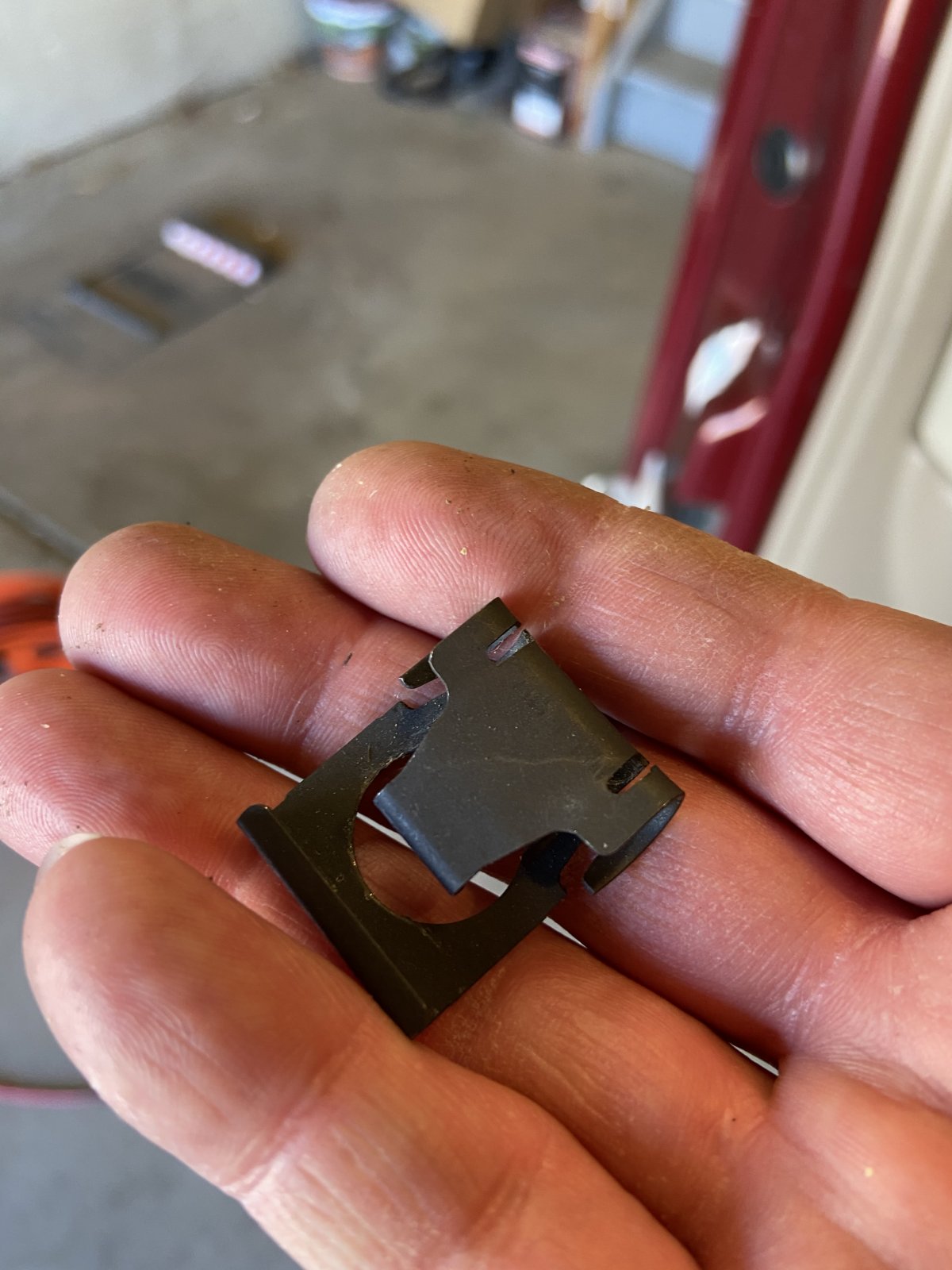

Was following my son the other day and his brake lights stopped working. Got to the cabin and checked all the fuses and they were fine. Did some research and found that the brake switch could be bad. The brake lights are working again but I don't like the idea of something being wrong and not addressing it.
2005 Yukon, right at 300,000 miles. I have ordered a new brake switch and an extra clip. Any advice or warnings before I try and contort under the dash?

It’s an easy job, just rough on the back.. this little clip is a PITA
