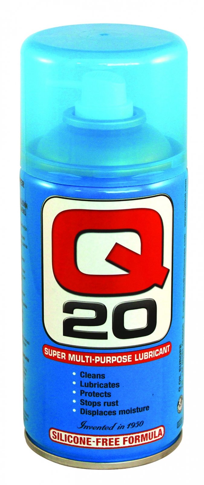

Try this ..

Yeah, but mine squeaked from the upper hinge point. Cured it with some penetrating Teflon lube.

Yes, like @Bill 1960 and @k1970 says, use a lubricant and anywhere the pedal pivots, attaches or moves-lube that area. Where the master cylinder rod attaches. But the noise may be coming from the master cylinder itself.

Thanks guys, since posting that I had tried wd40 and Houdini. Must have gone under it 5 times to find other angles. It stopped weeks later…assuming the lubricants made it where it needed to get to.
