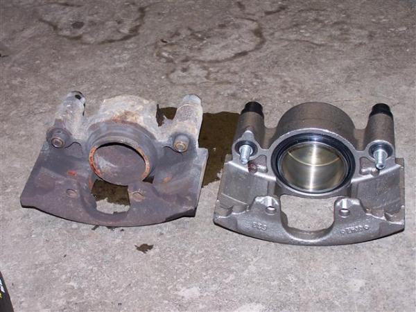

I don't know all of the combinations, but for mine, I asked partssource for a 1998 4x4 2500 GMC pickup caliper. It bolted right on.
---------- Post added at 08:48 PM ---------- Previous post was at 08:46 PM ----------
Is the 3/4 ton caliper still the "one big piston" design. I could probably Google or look it up on Autozone but I'm lazy. LOL
I would like a multi-piston design caliper ...
It's just a bigger single piston. 1/2ton on left, 3/4ton on right.
At least that's how it is on mine :)
You know, with such a weak braking system on these trucks, why wouldn't Chev put the 3/4ton calipers on the 1/2ton trucks anyways, right from the factory?
