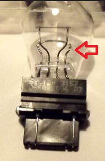

Remove one of the brake light bulbs from the taillight and see if both, or only one, of the filaments is lighting up. The shorter, thicker filament is the brake light circuit (in the pic below, I put a red arrow pointing to the brake light filament).
Which one is lighting up, or are both?
