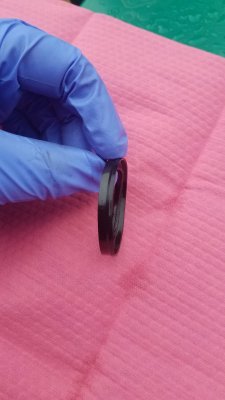

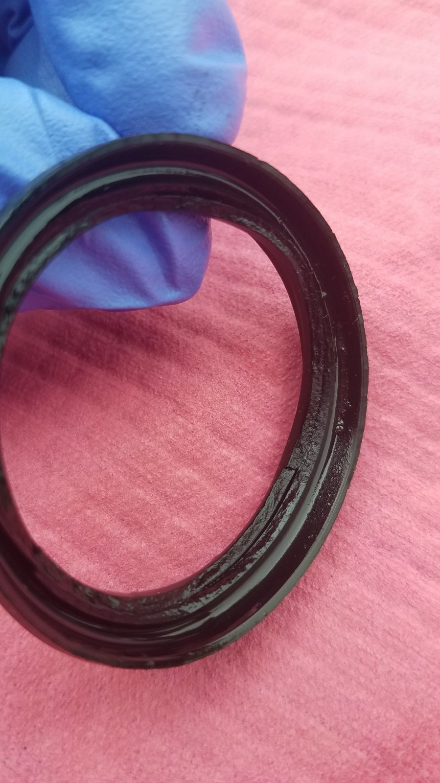

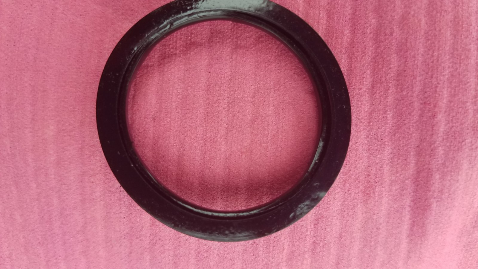

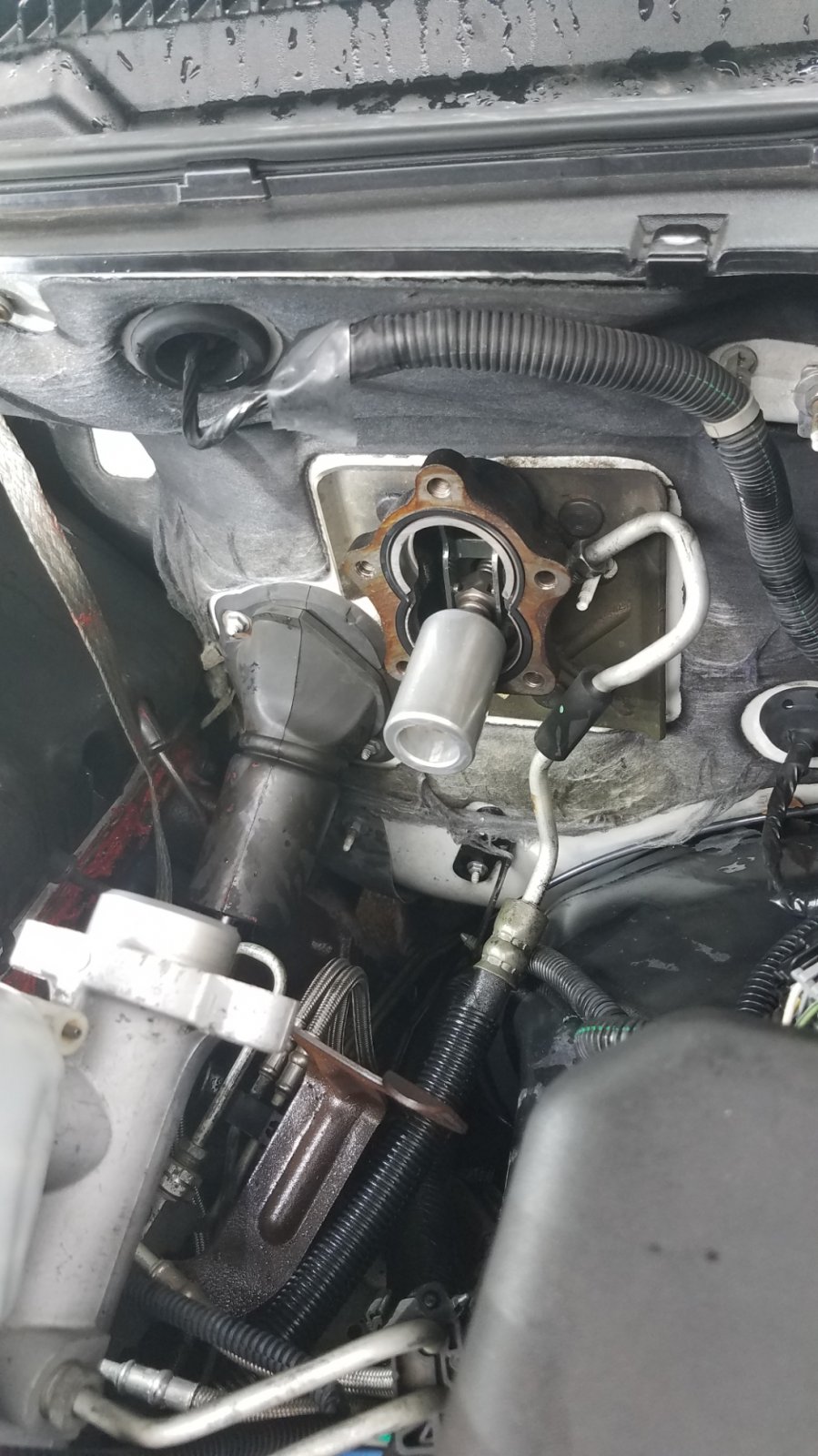

OK, tore into it today...
Oddly, the power steering fluid is kinda milky... ?
But the seal as trashed. New 6 months ago. Dunno. Seemed brittle, and in bad shape.
I just did what I did last time, pulled it apart under the hood, used a stick to push in on the brake pedal to help reassemble... All worked out fine it seems so far....
What would cause milky power steering fluid?
I did hose it down good at the car wash when I put a new power steering hose on it (thinking that was my leak)... ?
