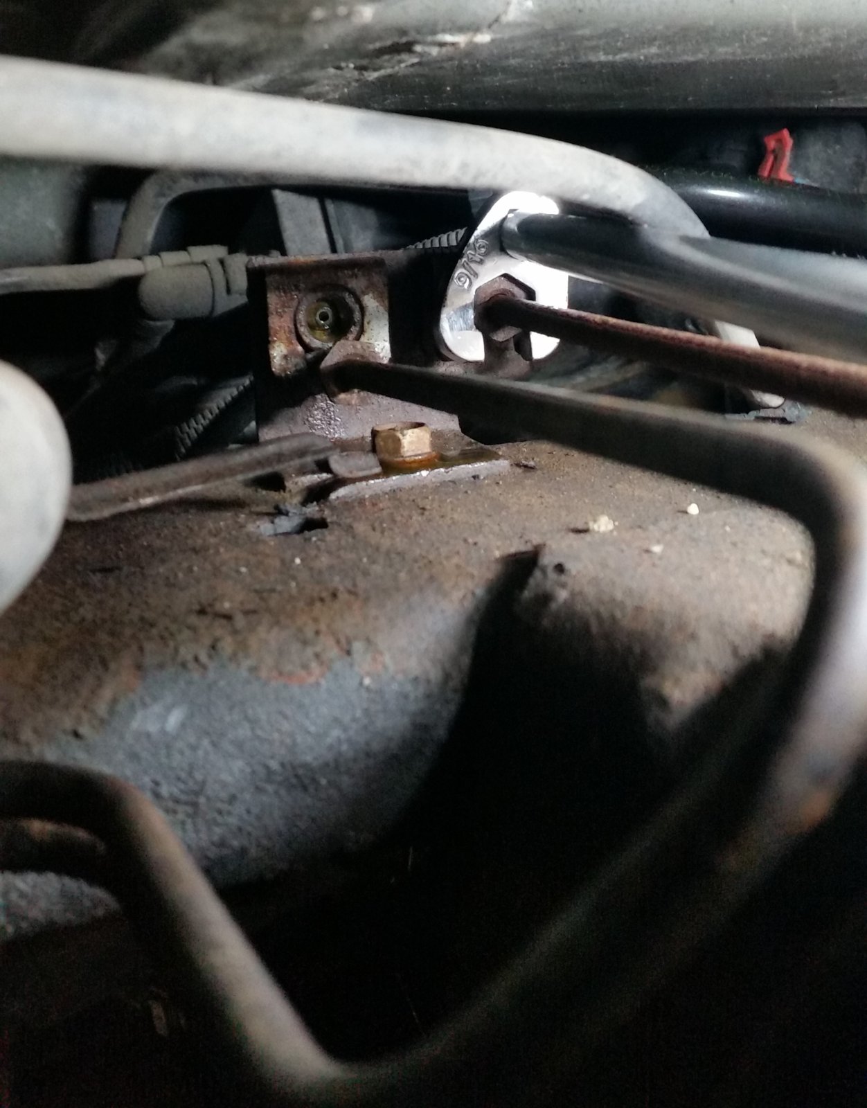

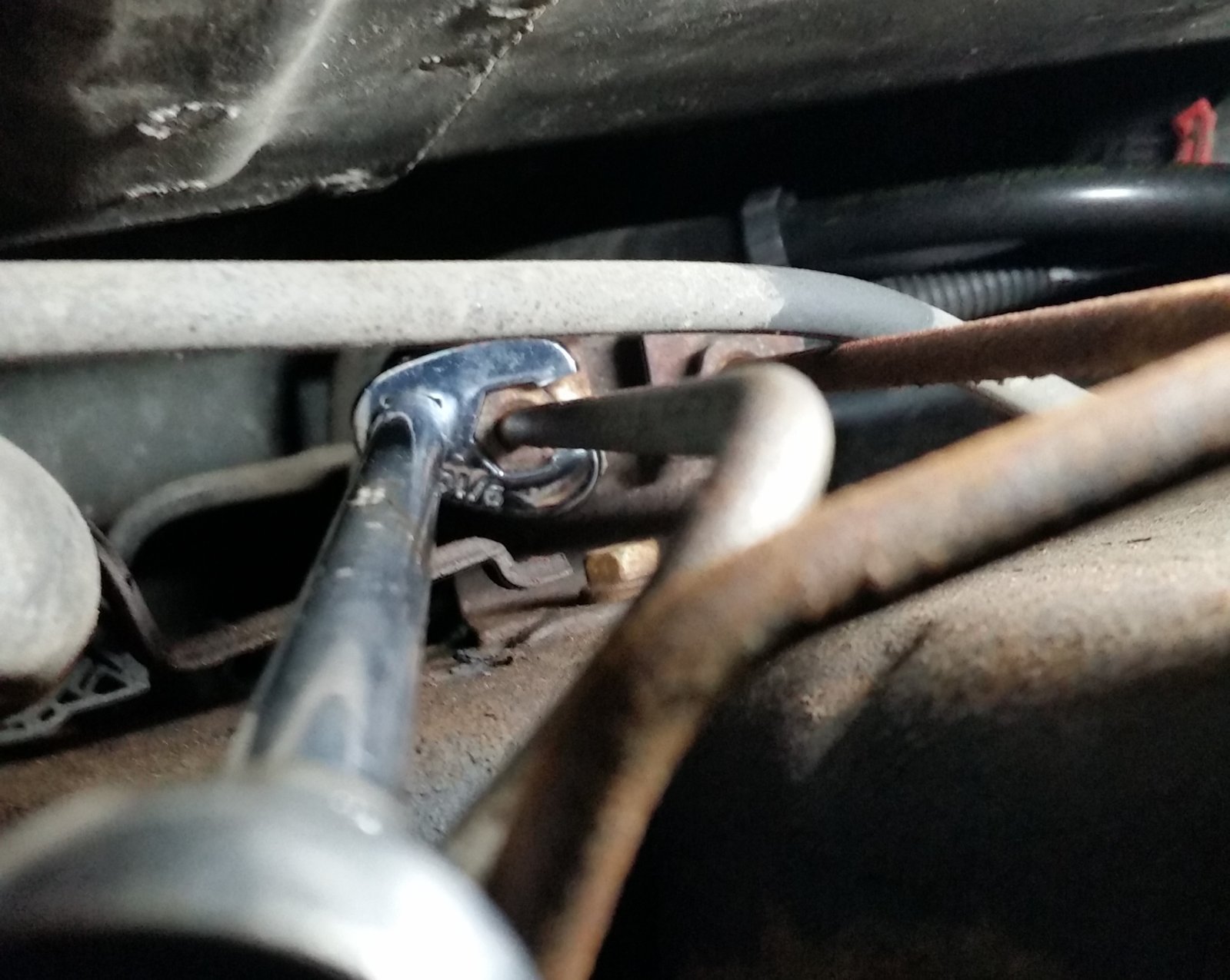

So today could have gone better. I swapped out the rear brake rotors, pads, parking brake shoes and hardware, and tried to tackle the four Goodridge stainless brake lines for the back.
The ones from the rotors to the axle hard line were a prefect fit and east to install. For the two that drop down from the frame to the axle it started off well, but didn't end up that way.
I used a crowsfoot socket head and a 12" 3/8" extension, and was able to swap both lines out in about 30 minutes.

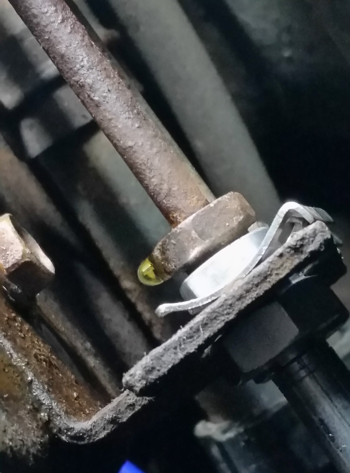

Unfortunately they both leaked at the upper fittings. I assumed I had the same issue as @corvette744 and the factory fitting was running out of thread before seating the flare in the fitting.
So I went out and purchased two longer fittings, and cut and reflared both lines. Put it all back together and it is still leaking the same way, weeping out around the pipe at the back of the fitting. I assumed my flares were bad, I took it all apart a second time and reflared them both again. I took my time and both flares looked good. Put it all back together again, and they still leak. I'm calling it quits on these lines.
Tomorrow I am going to work on the NNBS upgrade to the front, bleed out the lines the best I can with the drips to fill the calipers, and then drop it off at my mechanic to replace my fittings and flares, and figure out how to connect the Goodridge lines to my existing hard lines.
If it hadn't been for these fittings I should have finished the entire brake job today, front and back. I lost about 5 hours today taking these fittings out twice and in three times. I will definitely be contacting Goodridge to let them know my experience with their product.
