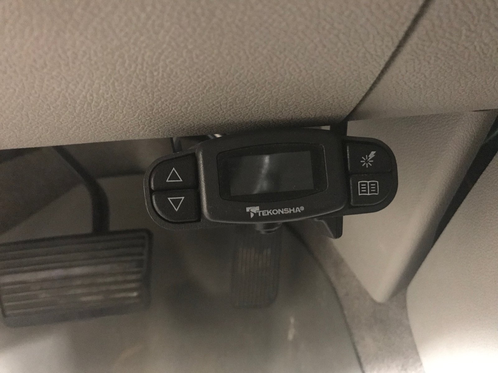

I agree with Chris. The factory brake controller is really nice because it integrates with the ABS system. But the Tekonsha P3 is a great controller in its own right. In fact it has more features than the integrated controller: adjustable gain for different trailers, accelerometer based control. (Does the factory setup use an accelerometer?) I've got one in my 2001 Denali.
For mine there were two holes on the trim below the steering wheel where it went in just fine. GM gives you a plug that is in a really easy spot to get to - not like on the Ford F250/Excursion where you need to plug it in blind.
The only regret I have is a really obscure one: there are two things wrong with the placement on mine. One, I have to really hunch over if I want to actuate the manual brake. Two, at night time, the controller's screen reflects in the driver's window and is really distracting.
I would have liked to put mine over closer to the passenger but I have a big center console. I also have long enough legs that I hit the Tekonsha with my knee unless it was anywhere but directly under the steering wheel.
Good luck!

Just like the other guys said, the P3 is an AWESOME controller. 120 bucks on amazon, and I love that it can differentiate between multiple trailers. I definitely dont need the same stopping power on my flatbed as I do my camper....and the P3 knows it.
That said you'll have to jump through some hoops. For some dumbass reason GM didn't put a nice little harness together for us, they couldnt be bothered. So you'll have to find the harness wires tucked up under the dash, and then wire them into the harness that tekonsha sends you. Why there is no plug and play is beyond me.
Also, if you wish to use the house charging circuit on your truck, you'll need to look under the brake master cylinder and find the red wire wrapped up and wire it into the aux terminal on the fuse box. Mine was acting weird, low voltage and such. I axed the ring connector and put on a gold plated one, in addition I hit all the terminals on the fuse box with the dremel to knock off the corrosion.

No, but tekonsha makes wires that use whatever quick plug they use for like 10 bucks. No splicing. My toyota sequoia was a breeze to install in comparison. I also dont understand why they dont hook up the house charging circut already....really weird.

Yup, when I bought my Tekonsha to put in my 2001 Yukon back in 2007 I ordered it with a GM cable. There is a plug receptacle under the dash for it to plug into. I also had to install a fuse in the box under the hood and hook up a wire to one of the stud terminals in the box. That was it.
The Yukon also came from the factory with a 12" wire bundle (sitting in the center console) to hook up a brake controller. It has the GM plug on one end and bare, non terminated labeled wires on the other end. I didn't use it because of the model specific cable that came with my Tekonsha, and it sits on a shelf in the garage.
