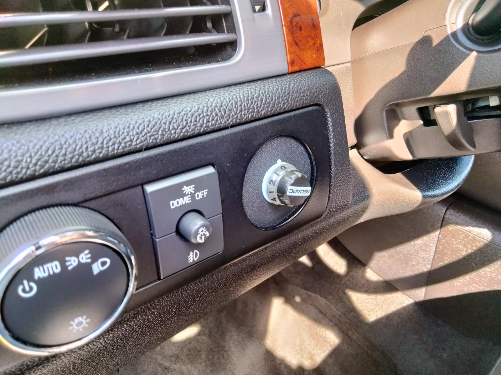

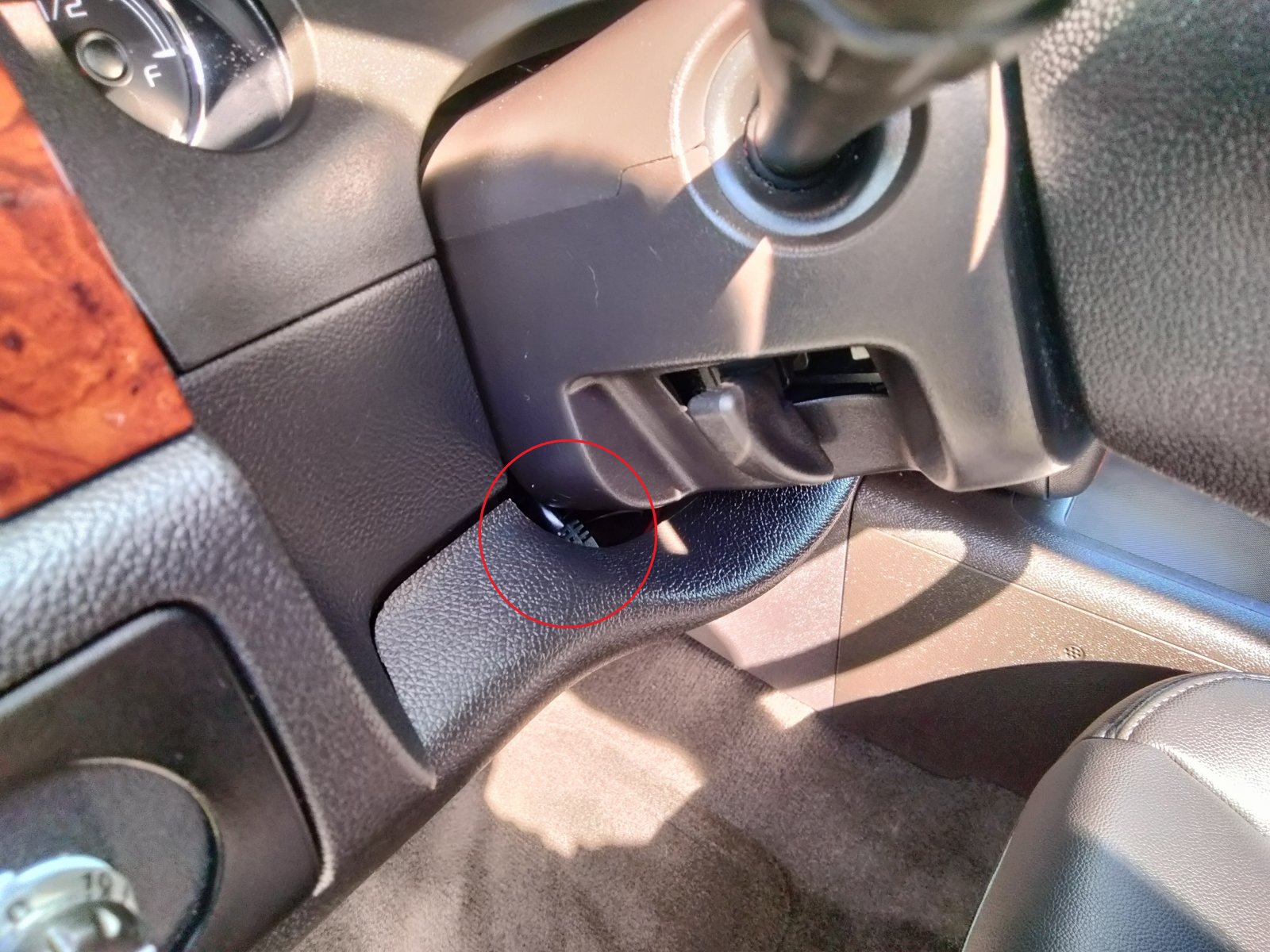

I installed a Redarc brake controller @ 6 months ago. My Tahoe is RWD, so I purchased a GM headlamp switch plate (25810643) for a 4x4 and swapped out the other one, some Kydex, and fashioned a mounting solution for the Redarc knob that makes it look OEM. I also mounted the Redarc control box on the backside of the kick panel below the steering wheel by drilling into the hidden metal shroud part of the panel. You can barely see the plug in the gap below the steering wheel in the provided pic.

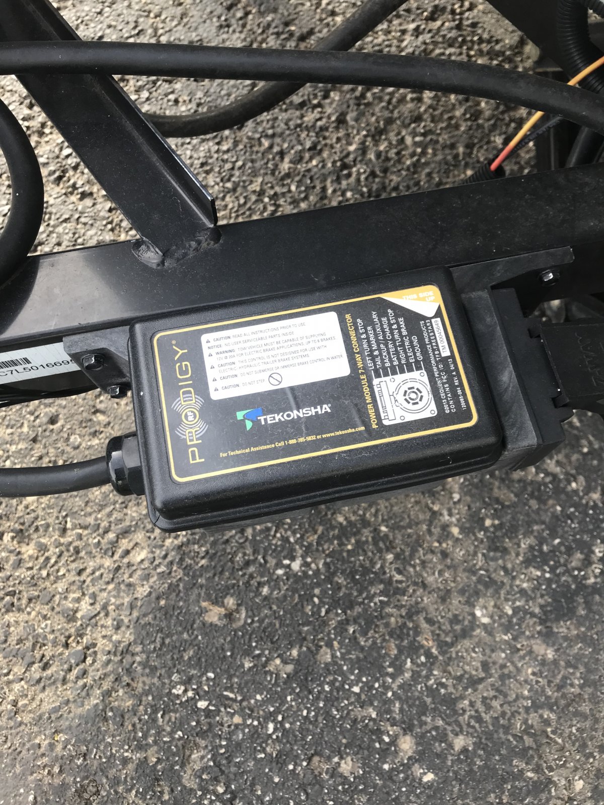

Hi there
Is the p3 you’re referring to a Prodigy?
I just bought a small hybrid popup It has a prodigy controller mounted on tongue
But the handheld in cab controller did not come with it

Hi there
Yes, Tekonsha Prodigy P3.
Sounds like the one on your PuP is the wireless kind; based on that I assume that your camper has brakes. You'll probably pay more for the wireless remote than you would a new Prodigy P3, but the wireless is handy, especially if the trailer is used with multiple vehicles.
