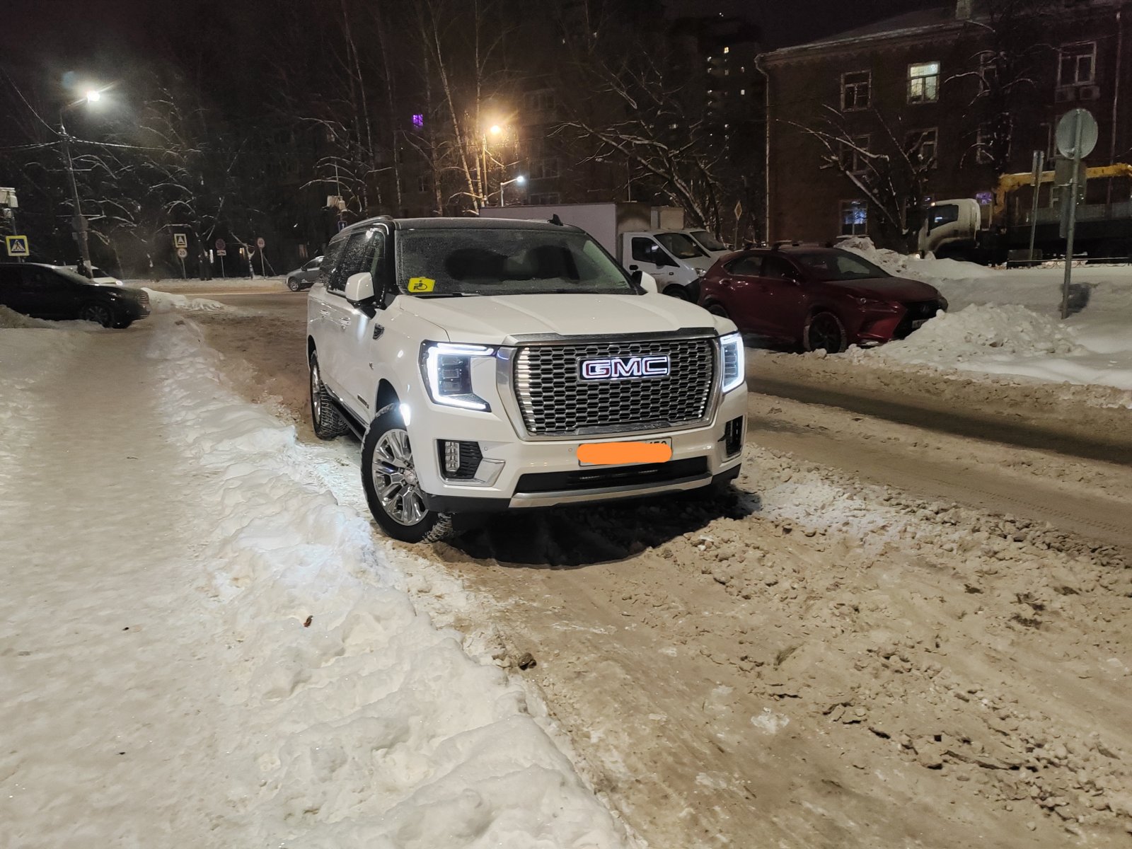

The front emblem can be changed very easily, about in 15 minutes.

Knowing what I experienced, I would bet money you can’t install the front either wiring in 15 minutes on a Tahoe. Just the emblem, sure, but not the needed wiring.

I put the emblem myself, you can break out the old letters with a screwdriver, it takes 5 minutes, and 10 minutes is to unscrew the front part of the left fender, disconnect the connector of the left headlight, and run a wire from the emblem to it)) only the upper bolts of the grill are unscrewed))

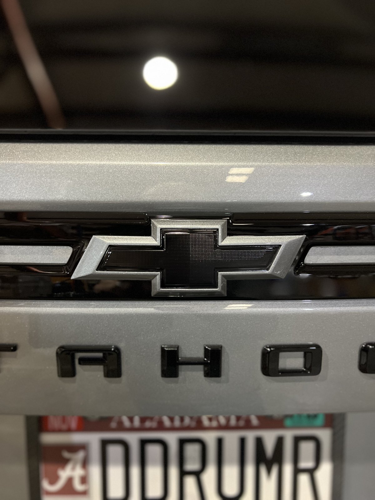

I had the chrome border painted grey to match my truck. To remove I took a step down bit and drilled through the original center part of the bowtie, then took a flathead screwdriver to remove the center sections. Once removed you will see the clips holding the chrome border on, take your screw driver to de-compress those clips to remove. Much better than removing the rear hatch panel!:D
