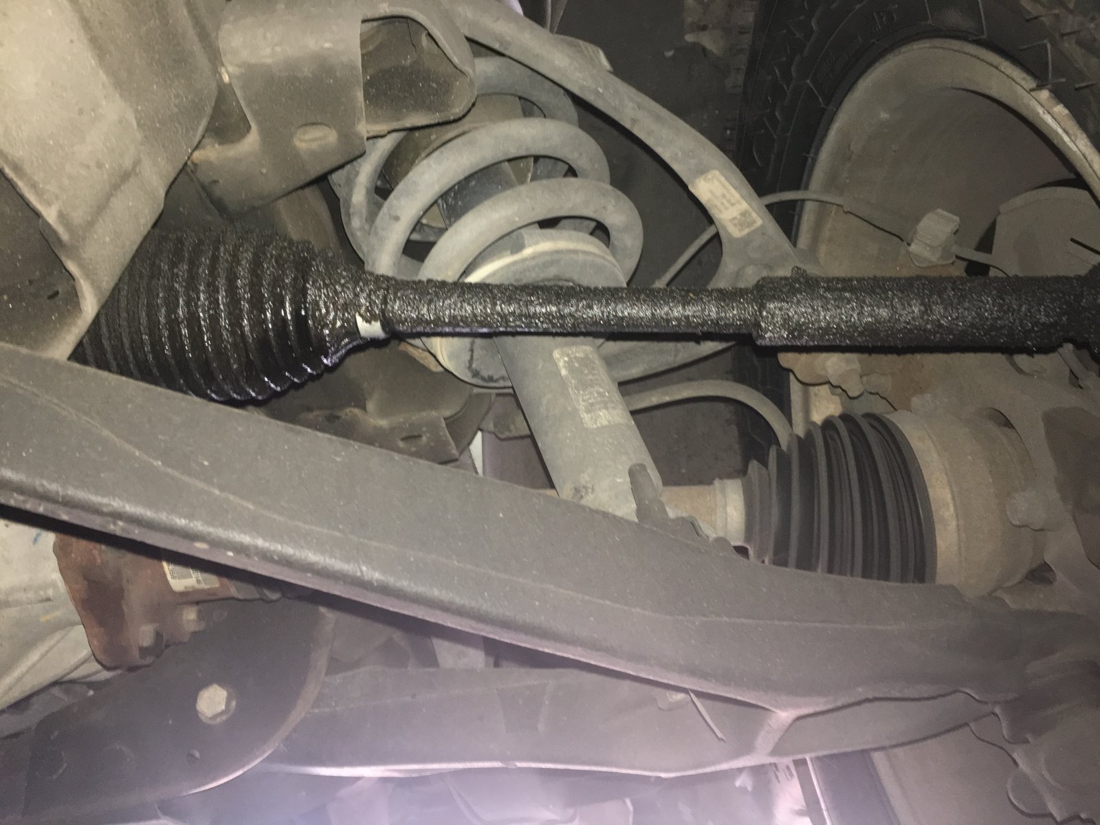

Ok, got under this beast. Learned how to drain and change my ATF and TCase Fluid. All around about $120 at Amazon Prime. Struts and shocks not leaking. That’s good. Saw this on the drivers side covered in gunk. I suppose dripped down on it. What part is this and what fluid do you think that could be on it? The one on the passenger side is clean.

Is your power steering fluid low? These are your inner and outer tie rods, and unless I'm mistaken, you have a leak on your rack and pinion. That being said, I believe its better to change the whole thing out rather than take it apart and replace a seal, at least on my Montanas. Let's see what more experienced hands have to say. The tire guys should have noticed this and brought it to your attention. They might have missed out on some work!

About six months ago I was low on power steering fluid and so I filled it to the proper level. I just checked this afternoon and it was only slightly low, maybe 1 to 2 mm. So I added a bit more. I’m thinking I should clean off the tire rod ends and keep an eye on it for short while. Also want to hear what others have to say about this.

Anytime. Keep an eye on your alignment too especially since you just put on new tires. Watch for inside or outside toe wear on that side.

if your able I would change the rack n pinion, these are not generally known to leak that I know of so you could probable save some money and go with a used one.
