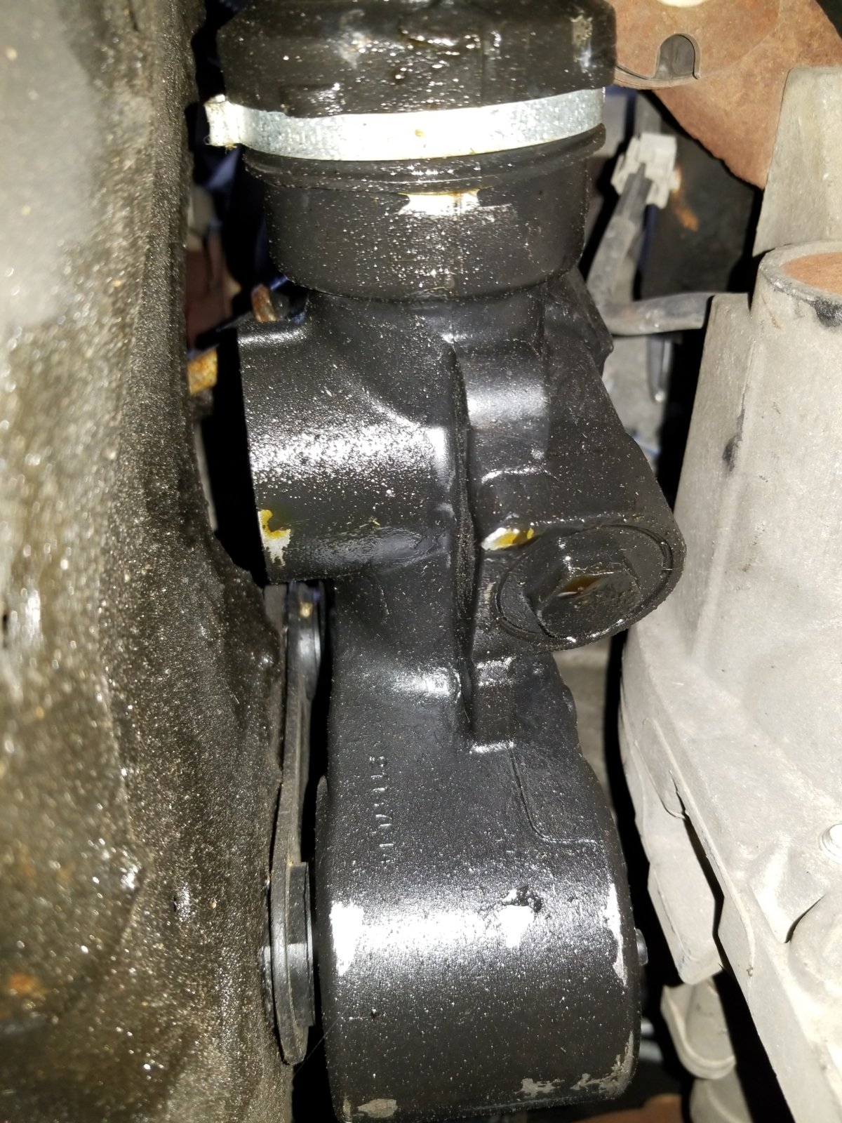

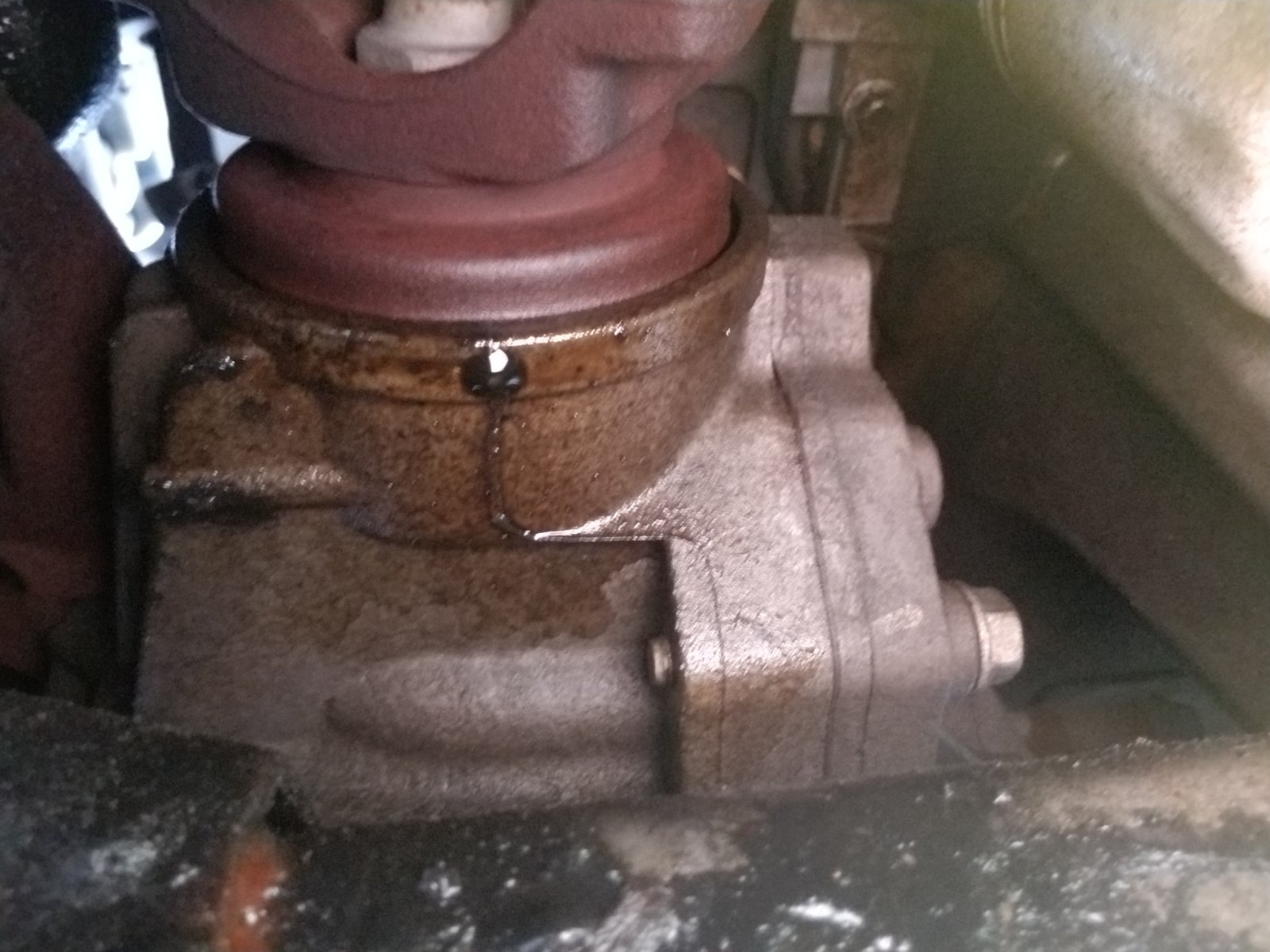

Good to know. After crawling under it i have spotted 2 leaks at the front. One on part of the awd system and the other is the front driveshaft front seal

What got me thinking that was the photo of the front differential's leaking fluid.

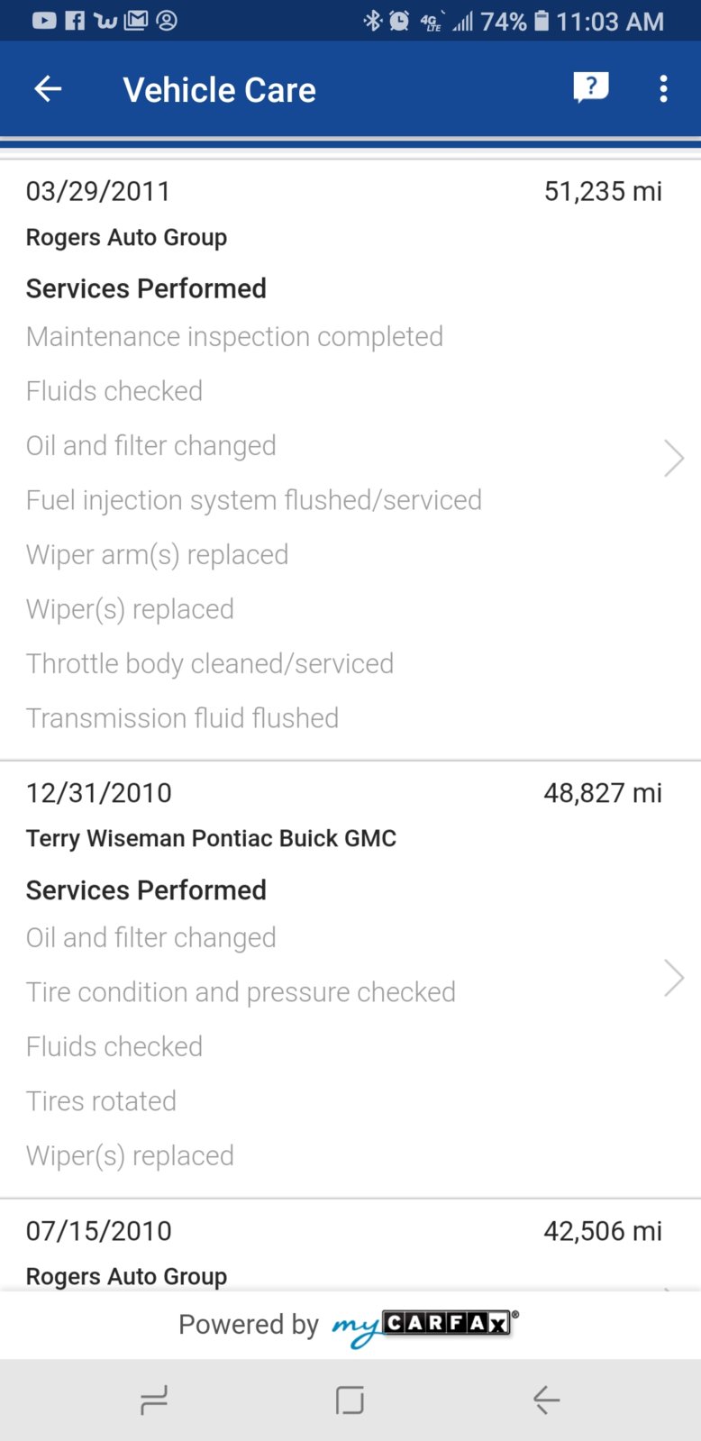

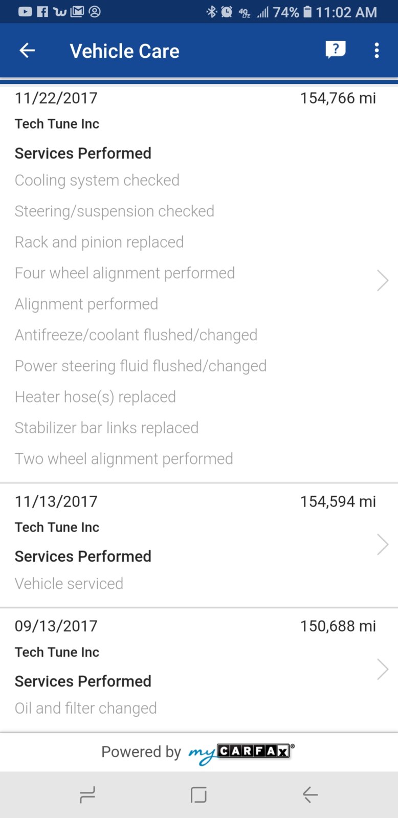

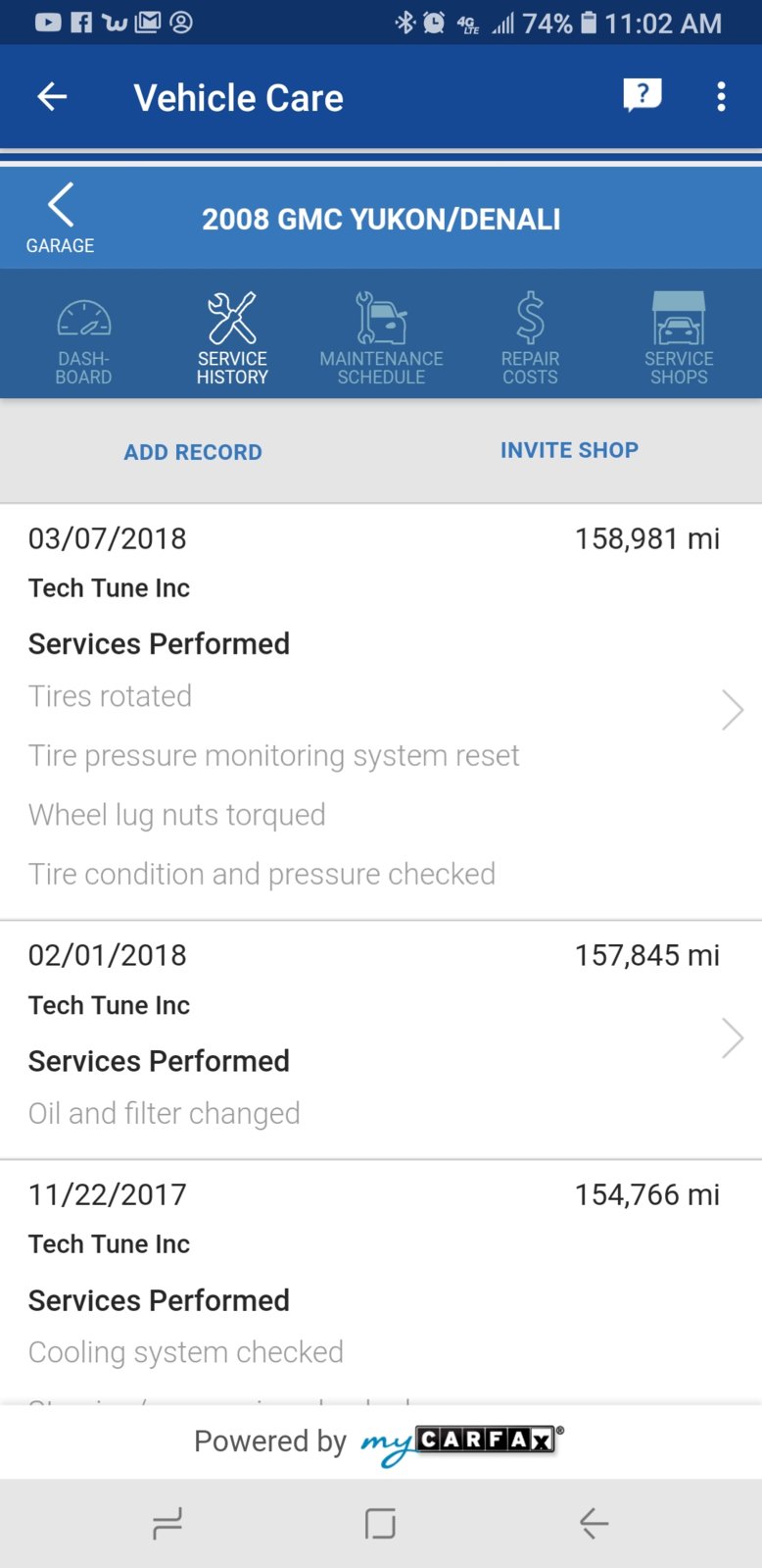

This is turning into a repair thread....im going to attach some screenshots of the car fax service reports. Called the shop that the carfax says did this service and they have no record of ever servicing this vehicle. Yet there name is listed about 15 time on this carfax so im at a small loss as to how they are listed as the repair shop....
Had seen where the rack and pinion had been worked on. Not sure if that could be where my leak was or not
