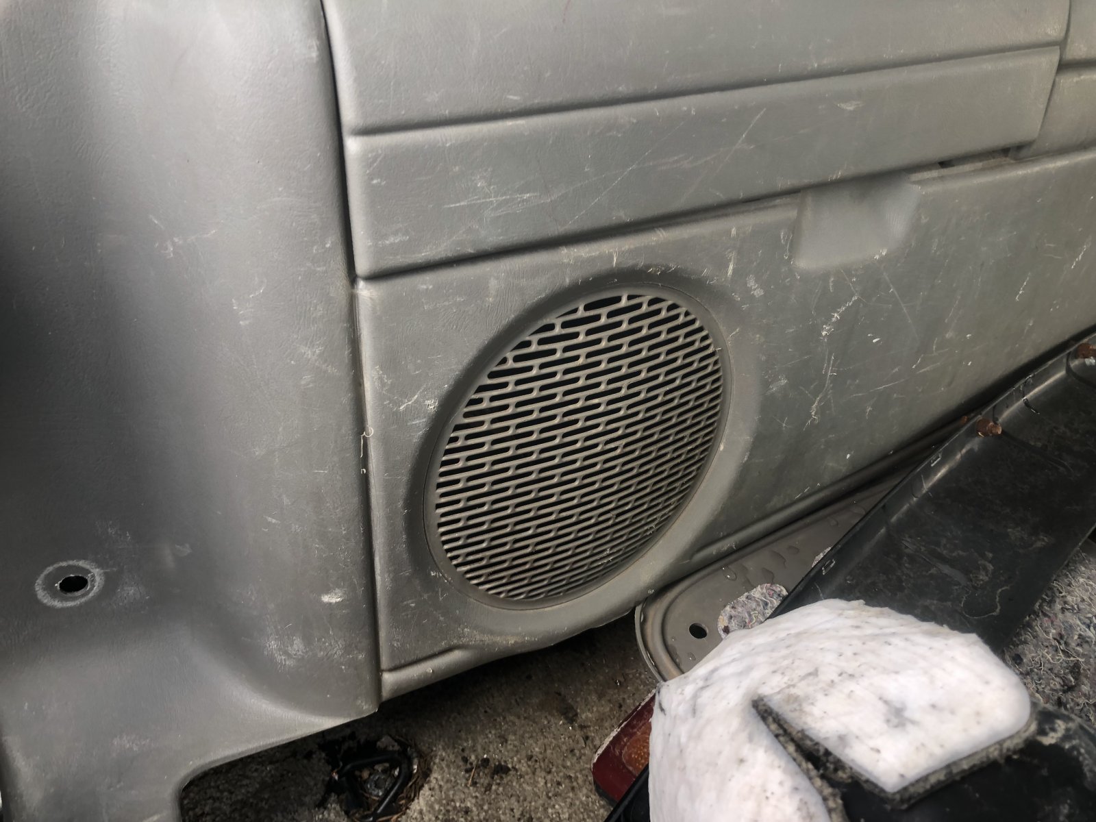

The 2002 and down Yukon XL's came with a subwoofer in the panel on the left side of the trunk.
The 2003+ comes with the Bose sub under the console. Has anyone added the old trunk sub in addition to the console sub?
I thought it would be cool to have both, and add the extra umph in the suburban.
Pics below show the factory Bose sub in a 2002 and down Yukon XL.

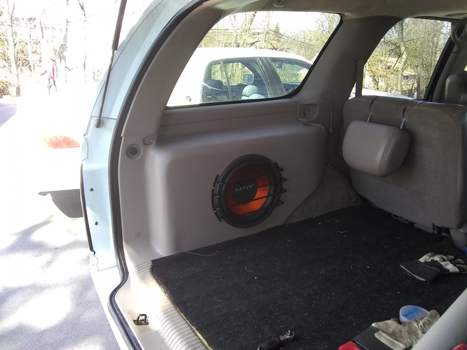

You could go the route I did OB. Stock Bose sub up front and a custom enclosure in the rear for a 12" yes it does show but only takes up about an inch of cargo space because of the grill.View attachment 224274 View attachment 224274
That's a nice rear sub installation. Just a note on subs. Subs in multi locations tend to cancel each other out. Something about the low frequencies. Depending on the separation some frequencies will be out of phase giving you decreased output. And some frequencies will be in phase giving you increased output. This can cause uneven output meaning sometimes you get dead/dull bass, then you get over powering bass, in the same song. For that reason I prefer a single 12" sub in a stealthy location.
