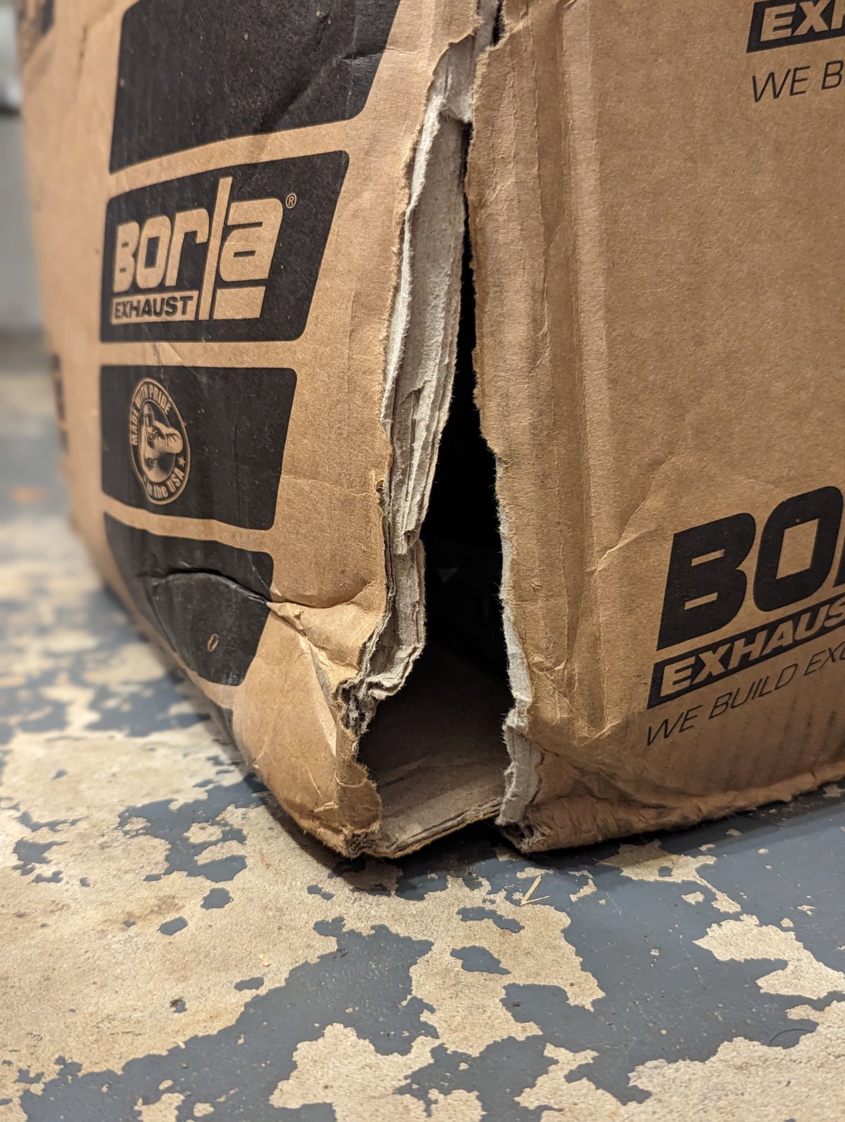

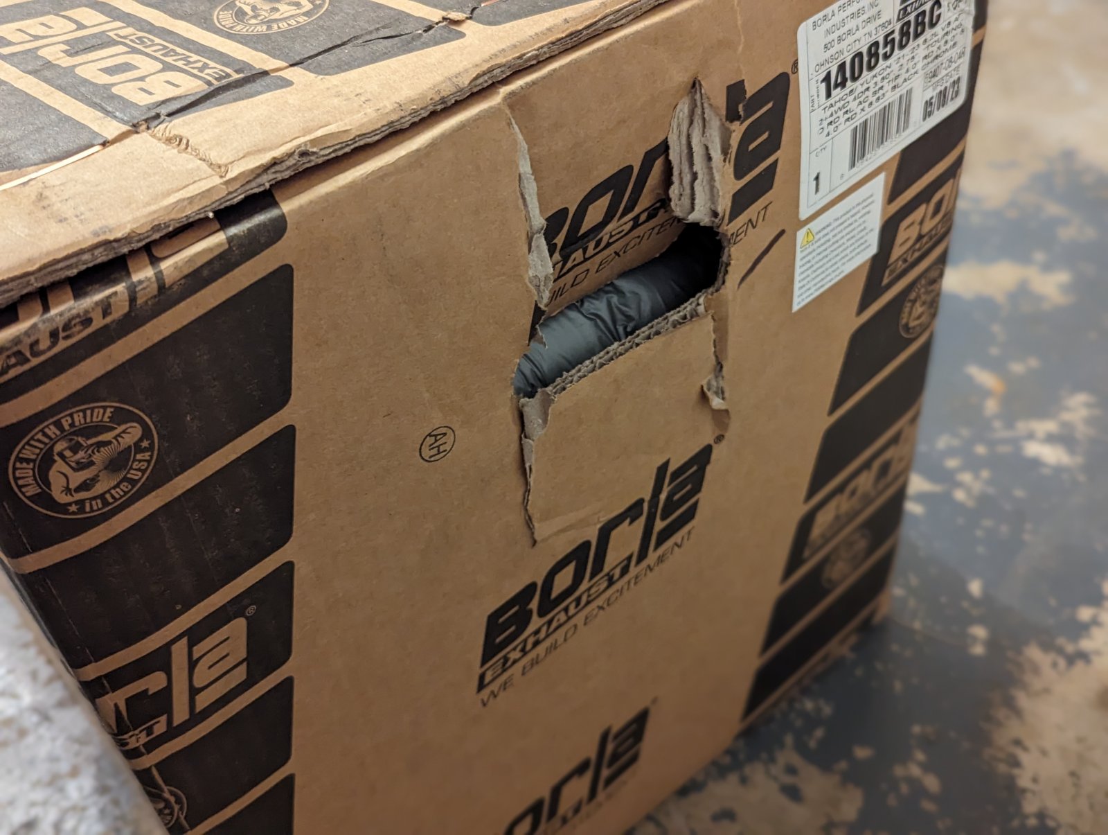

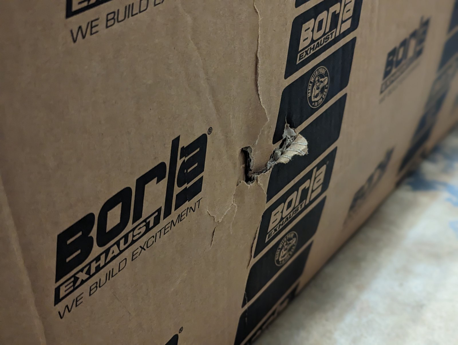

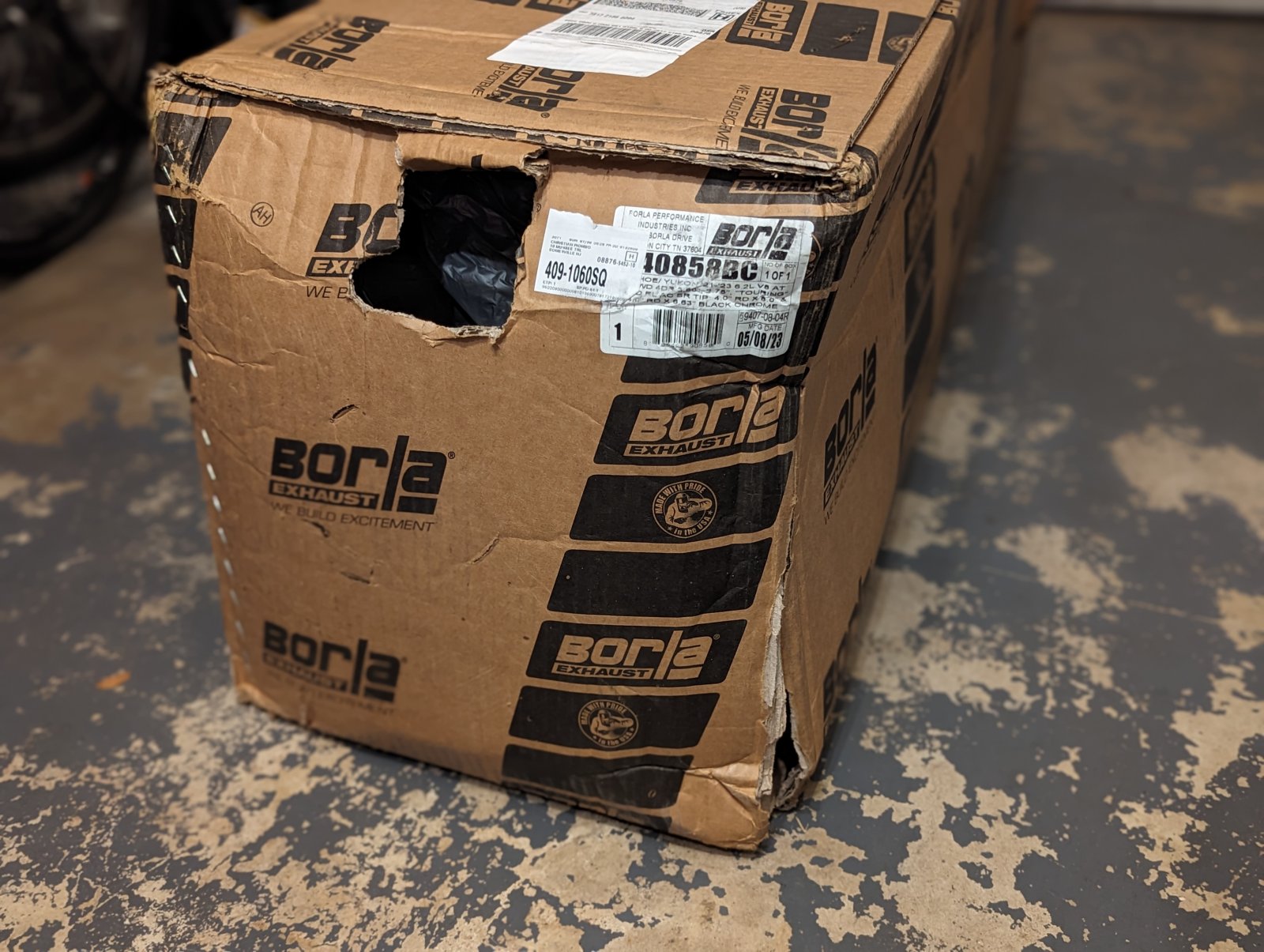

Just received delivery of my order, only three days after placing it! Bad news is the box was beat to shit on arrival. Good news is it looks like Borla did a pretty good job of packaging. May not be able to get around to this for a minute, but will update this thread once I do.
