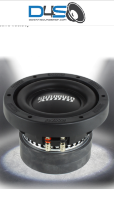

Anyone got 6.5 subs in there doors? I wanna put these in but with the Bose system and stock consol amp and sub being spidered in to everything Do I really have to pull everything out? Or is there a way around it?
