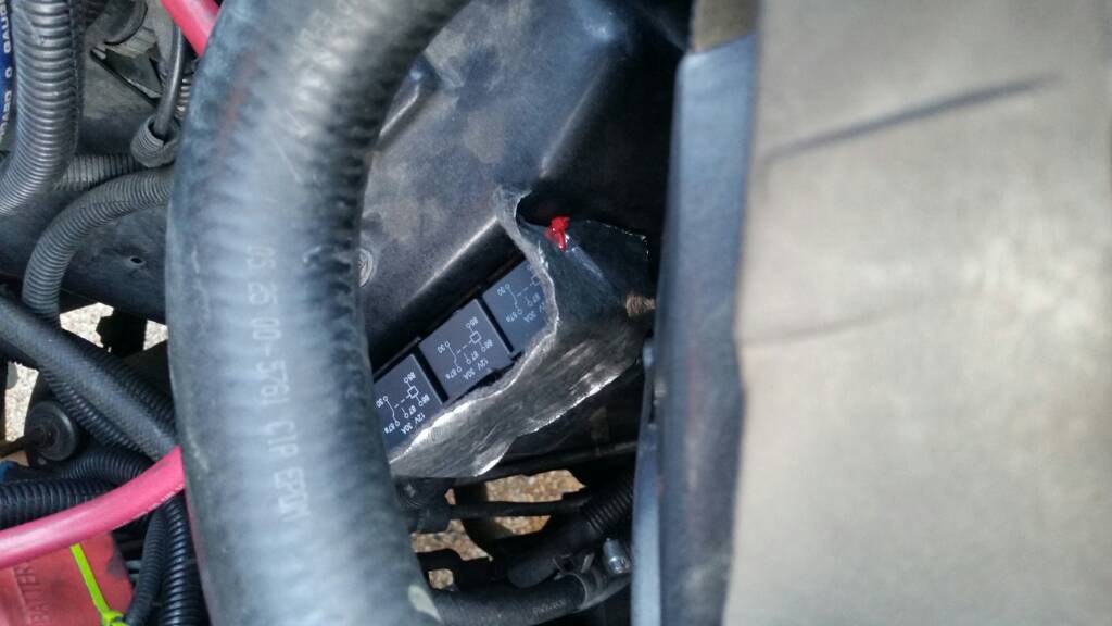

The relays are mounted on the plastic cover that covers the pcm. I put a heat shield over them to keep direct heat off the relays. Only the area around one plug on the ac relay has melted plastic. The wire itself seems fine and the heat seems to have come from the relay since the base of the same relay pin has melted also.
I ran ac when the truck was cold so heat from the radiator wouldn't affect the relay and the ac relay started to heat up like the load was too high for it. I cleaned the connection up and slightly crimped the plug so the relay fit more snug. I would love to extend this harness to get the relays closer to the stock location.
@rivierracing where does the stock wiring harness get power? Does it connect at the junction box or directly to the battery? Just looking at power delivery and possible voltage drop.
The ac relay is on the right. These relays are rated at 30a but the guy at the parts store said they are not rating for cooling fans. Tells me this after i bought, installed and fried one...The 40a ones I ordered are.
