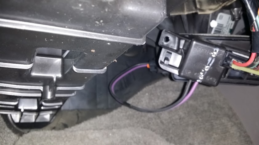

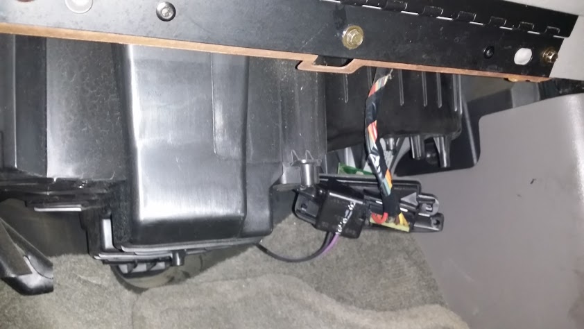

I started my daily driver 2004 Tahoe yesterday and put on the A/C only to find out that the front fans would only work on high. I did some research and after checking the fuses I decided to look at the fan blower resistor. Here is it's location partly removing the cover and the resistor:
Here are two more attempts at close-ups of the resistor partly removed:

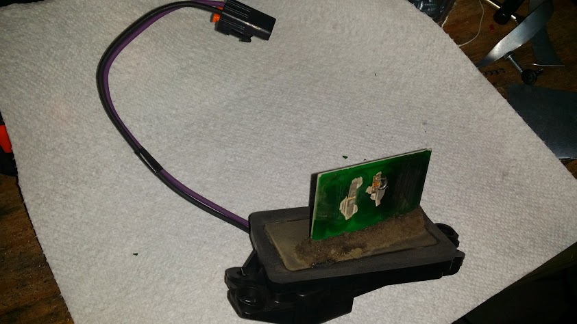

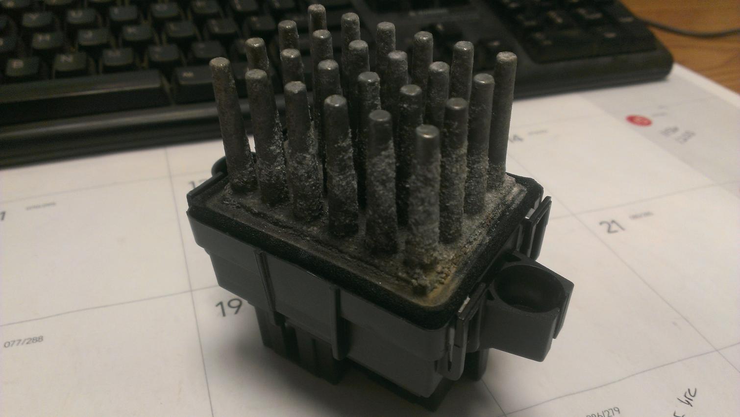

Here's what it looks like removed:

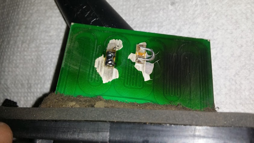

I noticed that one of the jumpers had disappeared upon closer inspection. I then cleaned up the connection with some 220-grit sandpaper and reconnected the resistor to the blower motor and jumped the connection with a screwdriver to test. Jumping the connection gave me my 1-4 fan speeds back:

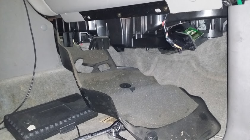

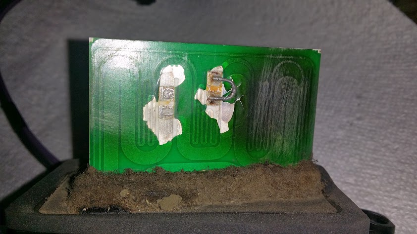

I soldered the connection back and here it is in all it's glory before being reinstalled:
Now I have all my fan speeds back again.

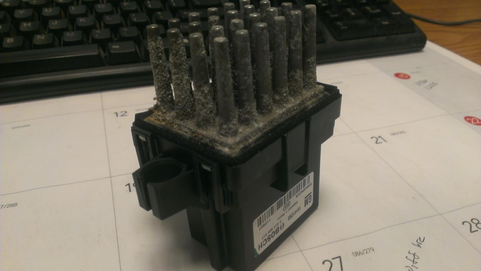

This morning, I started the truck, turned the heat on and nothing. Turns out, resistor bit the big one. 4 screws and ten minutes to fix. Took longer to find one, than to fix. Opted for original AC Delco Part. Spent $51.00. Saved approximately $120-150 on diagnostics and labor. Sweet!

Very cool. I'm not familiar with that part as it looks different than the resistor I had to repair on mine. It looks like the part number (from the first picture) is 15141283. Is that the right part number and where is the part located on your Tahoe?

The resistors look COMPLETELY different between Manual Temp Controls and the Digital Temp Controls. I believe the pics above show the Manual Temp Controls resistor.
