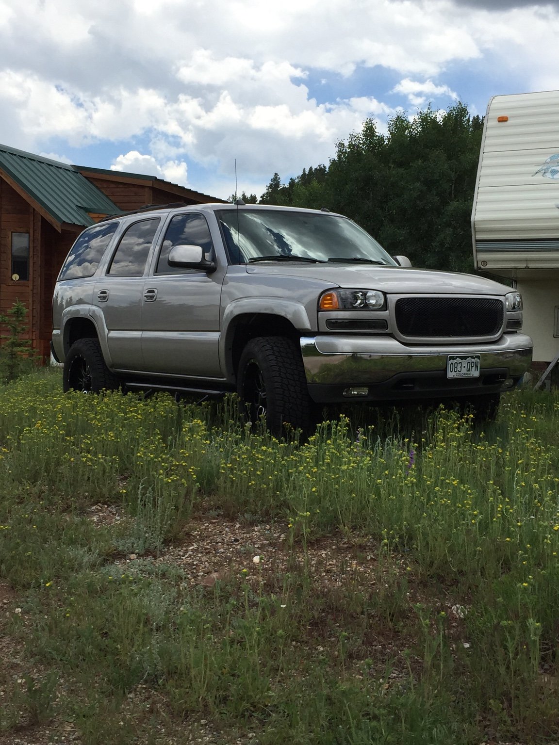

I went with Spyders black housings with smoked lenses. They do reduce light output a bit but I just upgraded my 35 watt HID's to 55 watt and that took care of it. The Spyders are pretty good quality. Here' a link to pictures. I tried to use TRS's Spyder Morimoto retrofits but they didn't work with these particular models. Still, these work well with HID in the projectors.

Man I absolutely love the look on yours! I am not real familiar with the HID lights and how all the different levels of brightness. How are the HID'S to install because I will definitely have to upgrade my lights going with the Spyder lenses? @Red Rocket
HID plug-and-play kits like mine are extremely easy to do but you need to be sure to start with good quality projector headlights to start with. The factory Denali's are decent, as are Depo's and I found the Spyders are too. However most of the other aftermarket ones are crap and will not work good, and might even blind oncoming traffic. HID retrofits where you remove the projector assemblies and replace them with ones made specifically for HID are way harder to do. The best way is of course the more difficult method. Mine have decent cutoff lines and actually light the road well but not as well as a full retrofit.

HID plug-and-play kits like mine are extremely easy to do but you need to be sure to start with good quality projector headlights to start with. The factory Denali's are decent, as are Depo's and I found the Spyders are too. However most of the other aftermarket ones are crap and will not work good, and might even blind oncoming traffic. HID retrofits where you remove the projector assemblies and replace them with ones made specifically for HID are way harder to do. The best way is of course the more difficult method. Mine have decent cutoff lines and actually light the road well but not as well as a full retrofit. View attachment 64006
I think the plug-and-play would work for me. I did notice that the corners on your Yukon are black, whereas on the Spyders I am looking at have the amber corners. Is that something different for Denali's versus standard Yukon XL? @redrocket

I think the plug-and-play would work for me. I did notice that the corners on your Yukon are black, whereas on the Spyders I am looking at have the amber corners. Is that something different for Denali's versus standard Yukon XL? @redrocketView attachment 64027
Mine have amber reflectors too- that's a DOT requirement. They're black with smoke lenses though- so you can't see them as well. Those look like they're black with clear lenses.
