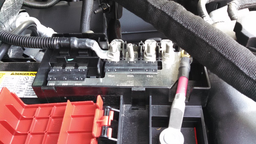

5) What is up with the battery in these things. The one I bought had a dead battery that did take a charge. I was going to swap the Optima Yellow Top from my 2007 into it, and instead of just the two top posts and one side post connection, this thing (as you guys in the know are aware of) has at least 6 more connections.
I can only imagine what a replacement battery would cost, but I suspect some of you have alternatives?

In regard to the battery, there is a cover over the section closest to the engine, but it has a multitude of individual cables attached to bolts which seem to feed into another cable going directly to the positive terminal. If someone has a picture great, otherwise I can try to take a picture myself in the coming days.

yes the positive cable has a longer metal portion on it with fuses and other leads coming off of it and it has a rubber cover to protect you from accidently grounding out anything to it, but it will still be a standard 2 post battery, the key fob has to be done by the dealer or some locksmiths might have the electronics to do it if they are keeping up with the times, these 15+ are all locked up with cryptographic security now
This is what it looks like;

yes that's just a cover and lead to power more electronics in the vehicle, the regular battery is under that plastic plate/cover
