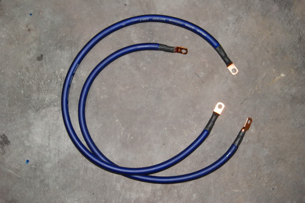

Do you have to use 0g wire or will 4g work? I have lots of 4g but im out of 0g. Will it make that big of a difference?
Brandon X
Brandon X
Nov 25, 2009
1,360
Michigan
4g will work. Anything bigger than the stock wiring will make a difference. However if you're running 0g on your system I recommend using 0g on the big 3.

I used a vice at my buddys shop to crimp the ring terminals. It's not really the best way to do it, but it's the easiest and gets the job done. It's better to solder the ends.

i was looking at a crimper designed for 0awg and small wire. it was like 200 bucks, but if soldering is the way to go then that doesnt cost a damn thing

Yeah soldering is the way to go. I don't know how to solder or have a soldering gun so I just crimped with a vice.
you dont need a crimper get you a propane torch from home depot some solder
use a vise grips to hold your ring terminal and use the torch to heat up the solder and terminal ones it melts stick your wire in it and hold it till it cools down then get some shrink tubing and make it look pretty here is a pic to give you and idea

I run 0g wire to the back where I have a distribution block to run my two amps. Ill just have to use the 4g that I have laying around. It is very good wire though, not the cheap stuff. And as far as ring terminals go I usually use my hammer as a crimper :) then I solder what I can. Has always worked well for me.
