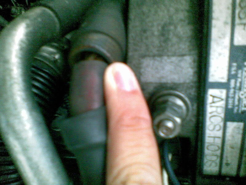

The wire that runs over the fan shroud, what gauge is that>? did you upgrade it? is it necessary to?? thanks
