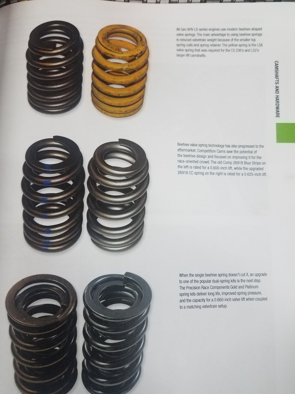

I did my homework and I as you said the Beehives can rev a little faster while staying stable but at the cost of possibly one breaking and messing stuff up. So IMHO for these trucks which only a maniac would push passed 7k duals are the way to go.
This book really is a must have for anyone with an LS engine, The torque specs in the back make it worth its weight in gold. Nothing is worse than googling a torque spec with greasy hands.

View attachment 259278 View attachment 259279
I ordered that book. I will someday build an LS from the ground up.

If that’s the same book that swathdiver referenced, I ordered a copy of it this morning. Glad to also have some validation that the dual springs are the way to go for this engine. Fascinating stuff to learn - all of it. Thanks for sharing your ‘homework’.
