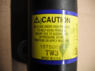

DSCF3491.JPG DSCF3493.JPG DSCF3494.JPG If your truck still had the original rear shocks on it (Black with a big yellow sticker on the bottom with a eight digit P/N) you just removed the Original Sachs load leveling shocks that are close to 400.00 ea. if the truck ride is firm and they did not have oil on them they were still good.
Thanks everyone for the excellent information! Yes jonnytahoe I just checked and they are the original black shocks with a big yellow sticker. I re-installed them within a week of installing the Monroes and being very unhappy with them. Glad I didn't toss them!
