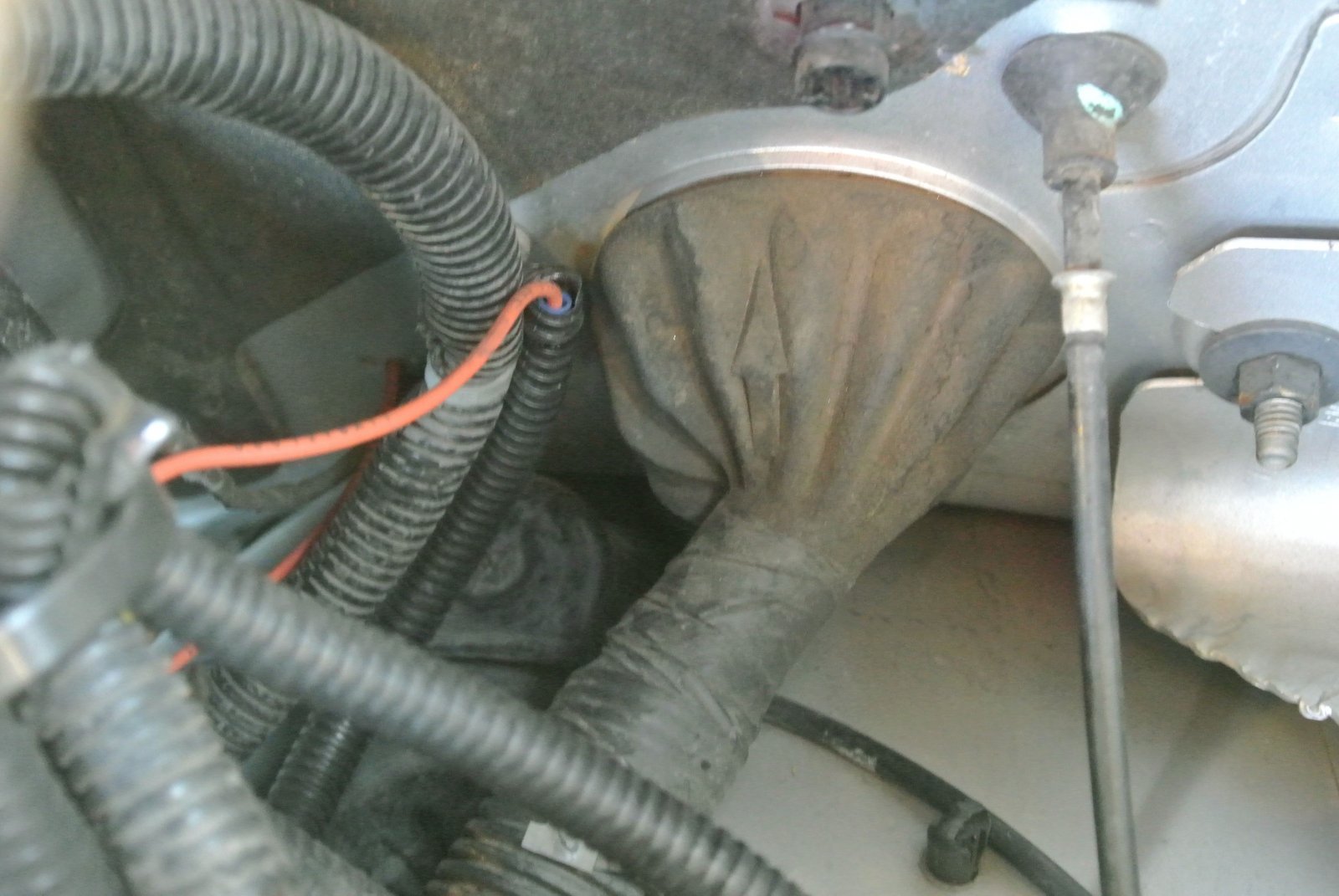

going to try and install my light bar on the front of the PPV, What is the best place to run the wiring through the firewall for the inside switch?

I would look at the various grommets that are currently in the firewall and see which one has room for your wires. There are a couple larger ones behind the drivers side of the dash.

just go thru right where the main harness goes thru it has a big rubber grommet around it. a small wire you can just push the grommet aside go around it, thicker wire may want to just make a hole in it and feed the wire thru.

there may be a small spot just to the right of it also
